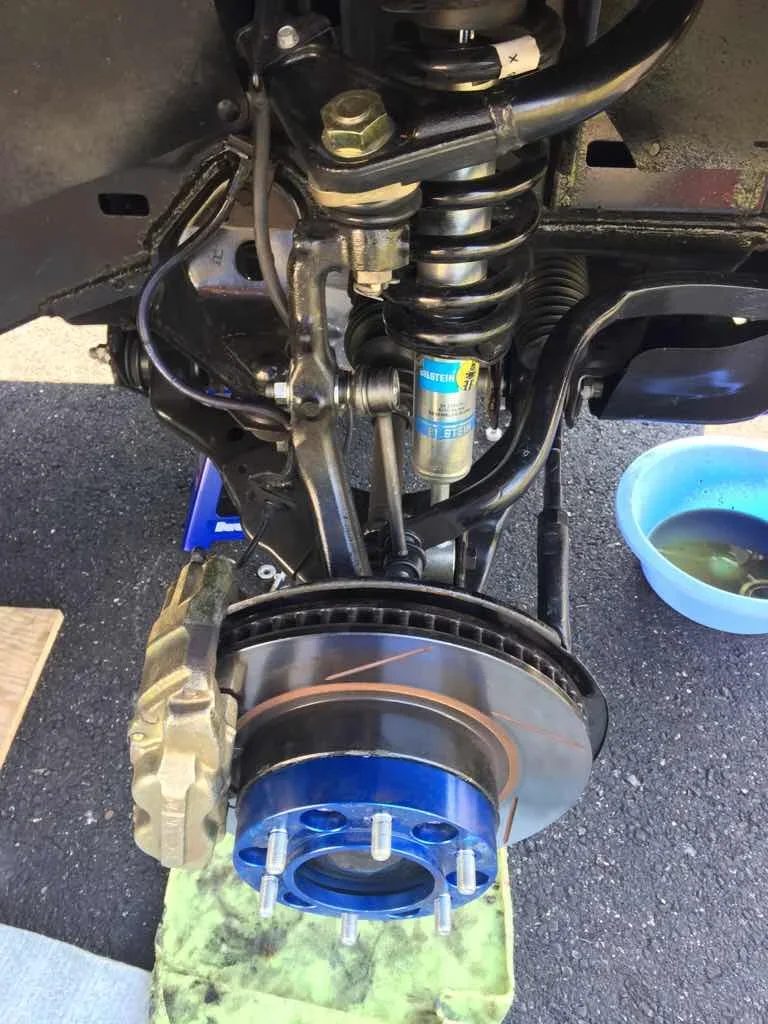

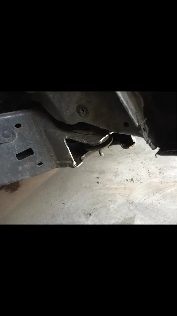

Since I know nothing about Toyotas I'll chime in. OME 2884 or 2885 springs depending on additional weight you add and height you want. With Bilstein 5100 adjustable struts will allow 2-3" of lift. But, the body mounts will need to be cut and the better way is to weld plate over what's left and paint!ImageUploadedByTaco Forum1445998939.479807.jpgImageUploadedByTaco Forum1445998957.546796.jpg

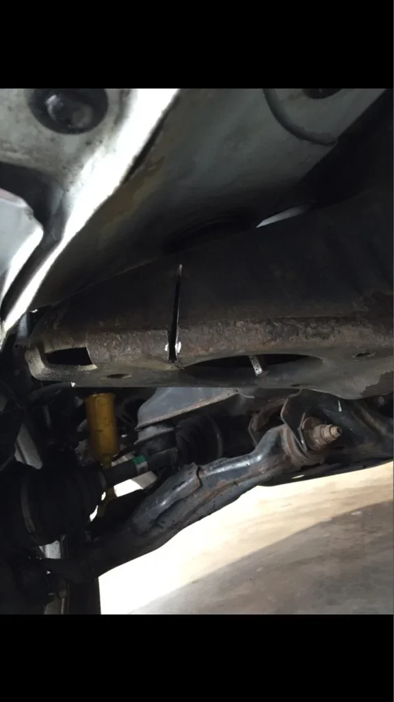

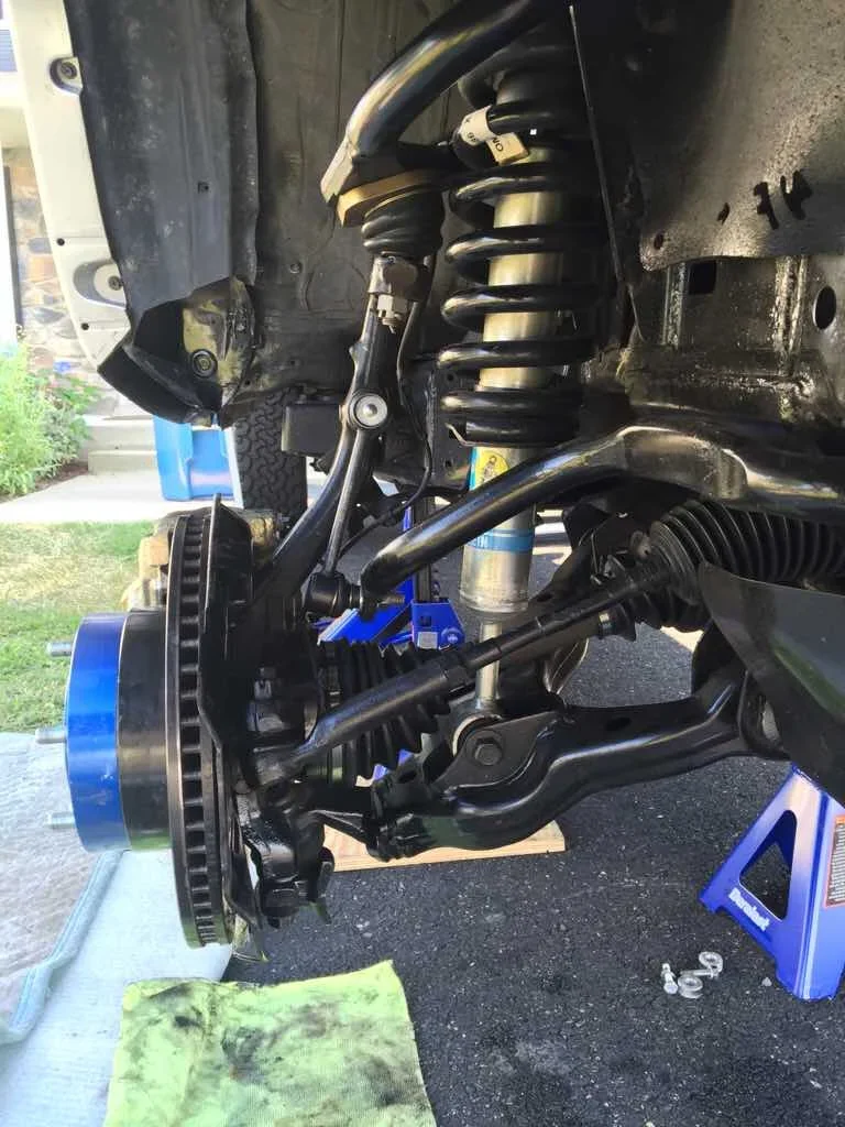

Also, if you have a Toyota factory 7.5" wide rim of some kind. You'll need wheel spacers of 1 1/4" minimally. Some people say don't use them for the potential of wearing out wheel bearings/ hubs more quickly. I haven't had any trouble with 1 1/2" on my FJ for 188,000 miles or putting 28,000 on my taco. They are coming off the taco this week for 17"X 9" rims with - -12 mm offset and 4.5 " of back spacing. Before my 6" BDS lift that I just did a month ago. I ran 7.5" sport factory wheels with 285/70-17" BFG KO's body mount chop and those 1 1/4" hub centric wheel spacers!ImageUploadedByTaco Forum1445999772.107268.jpgImageUploadedByTaco Forum1445999796.100357.jpg

I don't have pics that I can find. But, two cast pieces support the front diff assembly. They run front to back under your front axle assembly. They have a circular front with a bolt going through the middle of it. The kit has two aluminum 1" spacers. You take out the bolt pry with a bar the cast support down insert spacer use longer bolt. Same on the other side. This brings the front of each support 1" closer to the ground tilting the rear of the assembly up where the front drive shaft comes in helping it become closer to factory! Two problems with this for me! 1 my front skid now sits 1" clients to the ground which I don't want ! 2 my cv drive shafts are at the same jacked increased angles! I took them out! Bought a 6" BDS Kit that allowed 35's and decreased the front cv axle angles a few degrees closer to factory.
