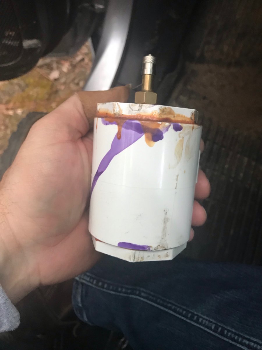

Okay, it’s winter, and it affects those little things, but I am tired of seeing a light on my dash that is erroneously reporting low tire pressures.
Can these be bypassed when you purchase aftermarket wheels?
I don’t need an idiot gauge for my tires,
Some folks put a piece of black electrical tape over it. I don't believe it can be turned off but I might be wrong.
The spare is almost always the low tire on the wife’s 4 runner. Check it if the other tires check out correctly
It works. I didn’t think it would, but it does. When I had my guys change my tires, I decided to ‘help them out’ and break the beads. Well- I have apparently been out of the shop and in an office long enough to make idiot mistakes, and of course broke a sensor. Valve stem itself is still good and in the tire. A little pvc, a valve stem, pressurize= no more light. Next set of tires- they will all come out and go into one sealed unit.
