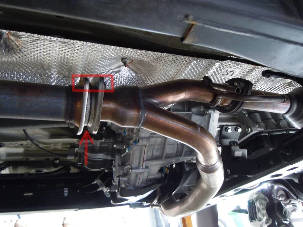

I'd just get a muffler welded in the stock location.

It's basically the same thing because the tubing is the same diameter as stock but personally I buy catbacks because I don't like chop and weld jobs.
You want performance, delete the cats and put straight pipes along with headers, exhaust, and intake.
I've heard long tube headers are best

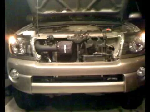

As far as air intake they're right you prob get the same if not better air from the stock intake, unless you get a URD intake. In theory I would assume it does give you best performance by the position in which it's placed, but I do know that they sell a performance chip or something that goes to the ecu to program with the URD cold air intake.

Urds intake WILL NOT pull colder air than stock at approx 40mph.
And i believe ur thinking of the maf calibrator.
Long tubes are not simply the best either.
Long tubes create more high rpm hp but lose some low end tq.
Shorties keep low end tq but dont make as much top end hp.
The 1grfe is such an oddball..... many engines have the oppossite effect with long vs shorties i believe.
Op, if u go long tubes, ypipe, and a large exhaust, like 3"... the truck will have the tq curve of a honda civic.
Been there done that, speaking from experience and not opinion.
