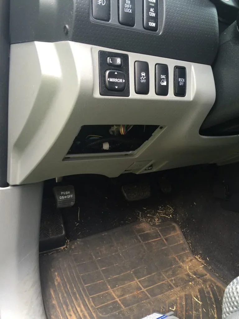

I have a 13 so hopefully yours is the same.. Pull the little tray to the lower left of the steering wheel off to access the fuse panelImageUploadedByTaco Forum1468030586.046849.jpg

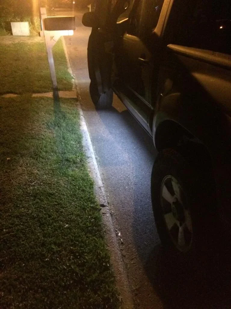

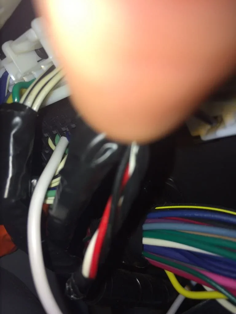

There's a black plug to the left or the fuse box.. The ground wire for the lights will go in the fourth slot from the left on the top row there's a blue wire in it and you can just wedge the ground wire in thereImageUploadedByTaco Forum1468030878.137898.jpgthe white wire is the ground for the lights and you'll need to run the power to the battery or any 12v constant sourceImageUploadedByTaco Forum1468030903.026272.jpg here's how they turned out.. That's how I did it, I'm sure there are different ways.
