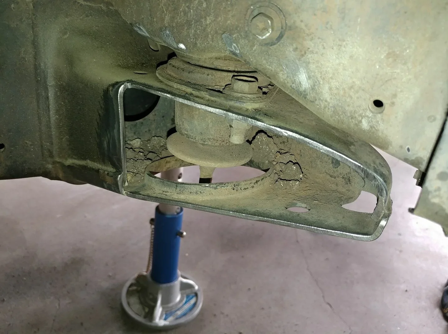

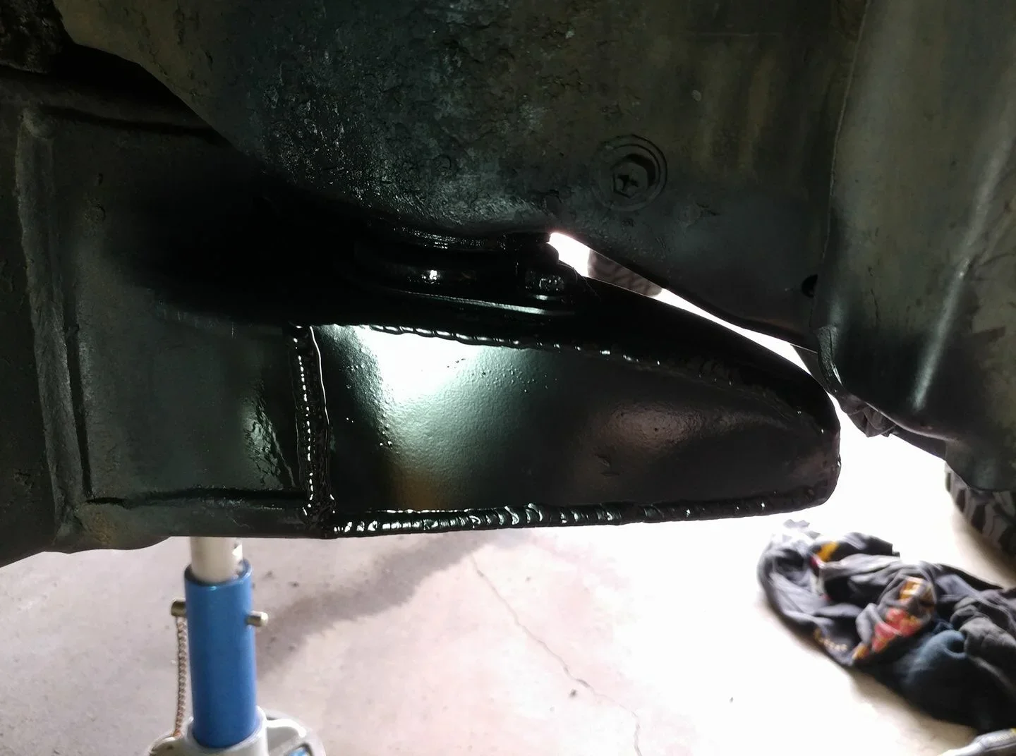

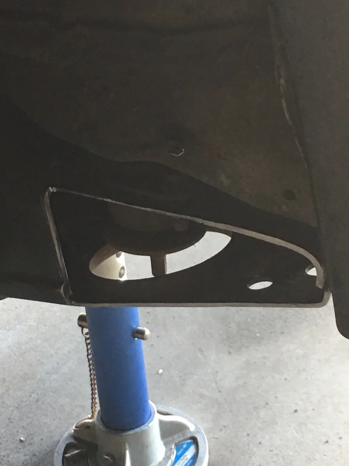

First things first, if you don't have a cab mount cut, don't matter how much you cut the fender or the flare, it's gonna hit the frame work of the cab support bracket. There's different company's that make CMC plates so do your research and go with what you want. I'm attaching pics of mine. IMG_1968.jpgIMG_1970.jpgIMG_1972.jpg
First things first, if you don't have a cab mount cut, don't matter how much you cut the fender or the flare, it's gonna hit the frame work of the cab support bracket. There's different company's that make CMC plates so do your research and go with what you want. I'm attaching pics of mine. View attachment 11967View attachment 11968View attachment 11969
