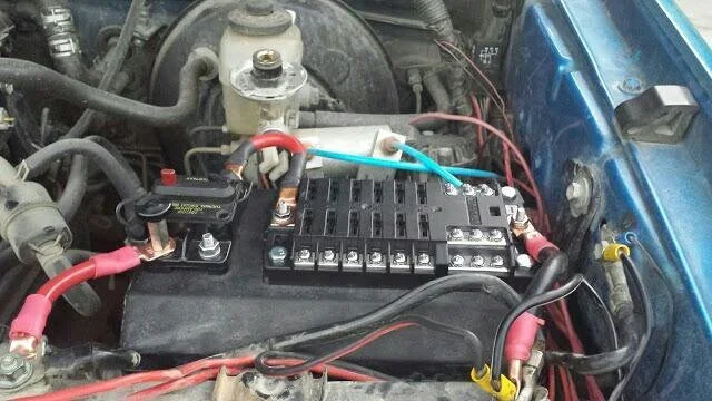

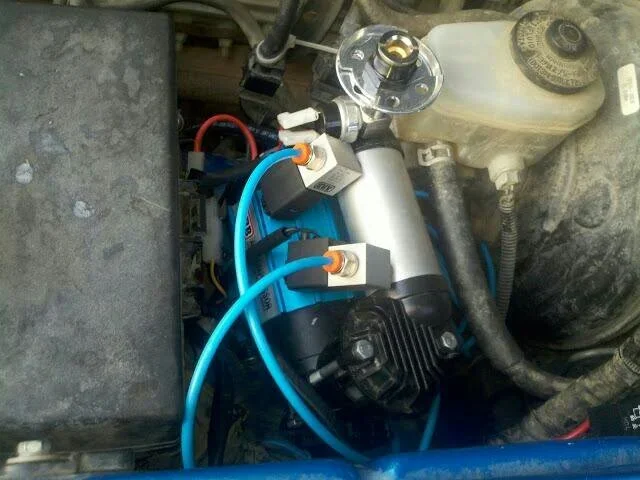

  12. whippersnapper02
    A buddy has a 4wd Sport 6 speed with ARB lockers. Here is where he mounted his compressor. It is just in front of the brake booster.
    Pic from Manwithoutaplan.

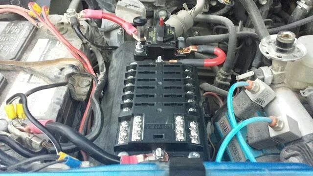

  13. whippersnapper02
    More...
  14. Manwithoutaplan
    Manwithoutaplan MOnty Lives on
    If i were you i would mount the compressor either in the back of the bed or on the passenger. FYI
