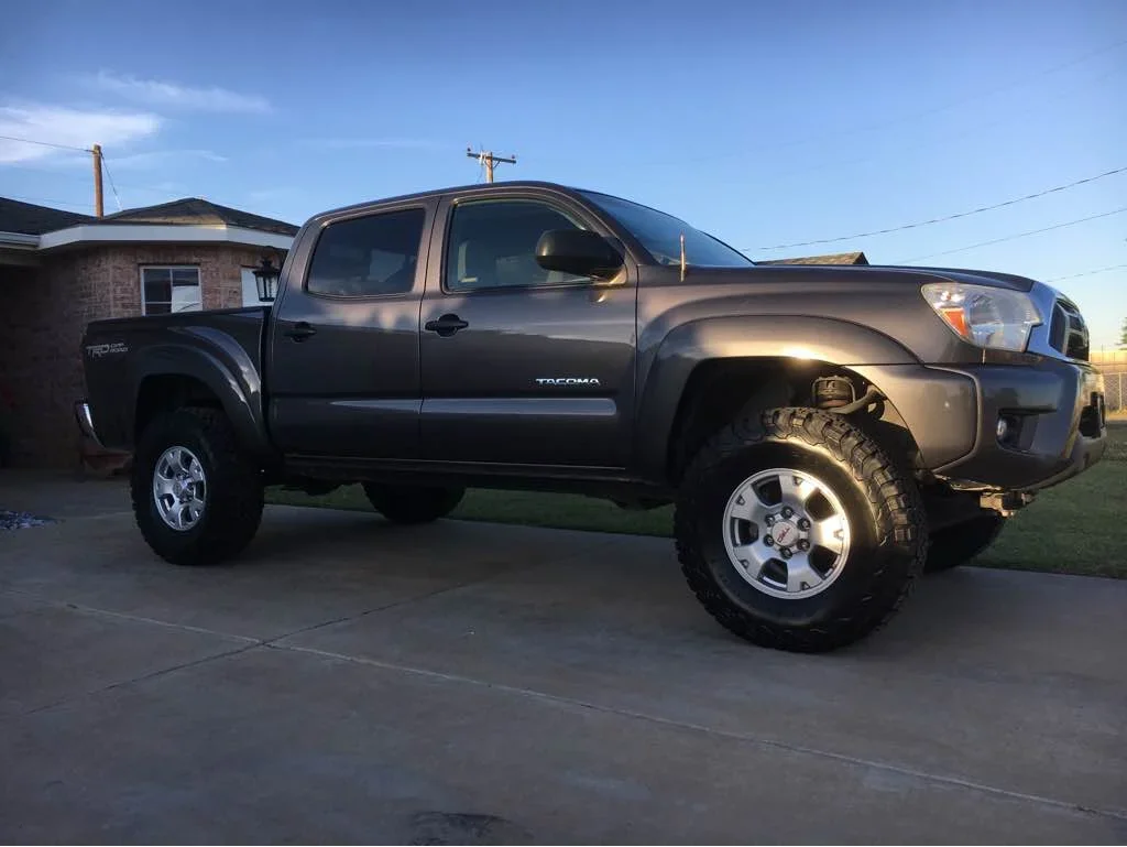

I do not have them on. A dealership here in lubbock had bought them thinking they would fix a camber issue on a truck and they did not solve there issue. They were literally installed and taken right back off. I got them for $150. I currently have a motofab 3" front and 2" rear. I am leaning towards an ome or icon kit in the future but for now was just curious if i should sale the ucas and make some money or put them on if highly recommended.

Hmmm...I'm not familiar with motofab lifts. It looks like you have the same coil in the pic. I still don't get it. If you went up 3in. the stock uca's won't work, and the Fabtech should have. We have the same truck a year apart.
I never put the fabtech on. I just bought them a couple days ago from a dealership that put them on someone elses truck to fix a camber issue but did not resolve the problem. Right now i am running a 3" spacer lift with the stock ucas. Have not had any issues but have only done highway driving so far since lifted. But i do want to install the fabtech ucas but just wanted to make sure nobody had anything bad to say about them or if they were recommended.
I should have seen the spacers. 3in is 3in weather you use coils or spacers. I did mine in my driveway with my son. The freaking things should work...you got a great deal too. Highly recommended here...
