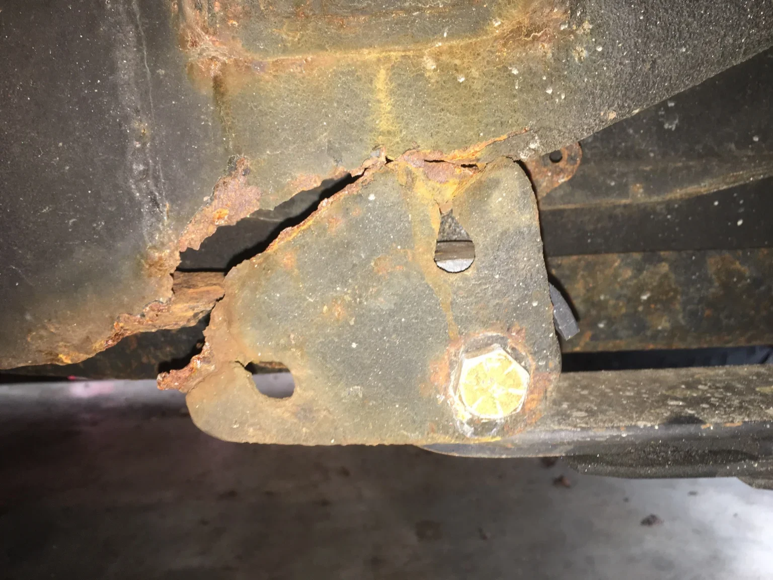

    Well here I go again just upgraded suspension and now this
  3. whippersnapper02
    Looks like it's been that way for a while.

  4. OR17TRD
    You had the bed mounts rusted off this seems par for first gens. Sucks none the less. Should have got the frame recall.

  5. 4wd
    4wd Well-Known Member
    Hangers obliviously shot, it's not too bad to weld on new ones but I'd def. go over my frame with a fine tooth comb, don't know where you're at as far as frame recall or even if offered still...

  6. OP
    mhinson79
    mhinson79 Well-Known Member
    Is Toyota offering the recall on 2001 Toyota Tacoma
  7. 4wd
    I'm not sure , I know for a long time Toyota kept extending the recall for frame replacement , even extended the areas of concern in the U.S. because they wanted them off the road (for liability I assume) But it shouldn't be too hard to find out through Toyota corporate..
    Bogunn likes this.
  8. OP
    mhinson79
    Just called Toyota the recall was offered till 2012 but the previous owner never had it fixed
  9. OR17TRD
    Sucks. Seems like they wouldn’t want that truck on the road and would still be willing to work with you on either buying it back or fixing it.
    ace80 likes this.
  10. 858_tacoma_guy
    858_tacoma_guy Well-Known Member
    I'm pretty sure they extended the warrantee again. I remember getting a letter in the mail few months ago saying the frame rust warrantee was extended again. Chances are Toyota should have to replace your frame or truck. If not, contact a layer.
  11. 4wd
    That really sucks man, but don't give up with one denial (or someone saying it's over as of 2012) Because I'm pretty sure what you were told is bullshit because I know there were a few guys on TW that were told basically the same thing but they kept at them & eventually some adjustments were made in the recall & at least 2 of them got frames replaced...
  12. OP
    mhinson79
    Really well in that case I’ll keep them on speed dial
    Bogunn and OR17TRD like this.
  13. kp.taco
    kp.taco Well-Known Member
    I got a letter in the mail from Toyota yesterday saying to take my 2009 in for a frame inspection..
  14. 4wd
    Yeah it surprised me that some 2nd gens were included in this recall seeing how 1st gens with little to no undercoating started the whole frame rot issue, you'd think Toyota would've made a note of it so it wouldn't be an issue with future production..
    Bogunn and kp.taco like this.
