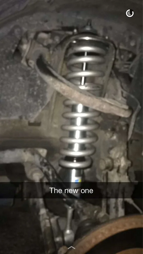

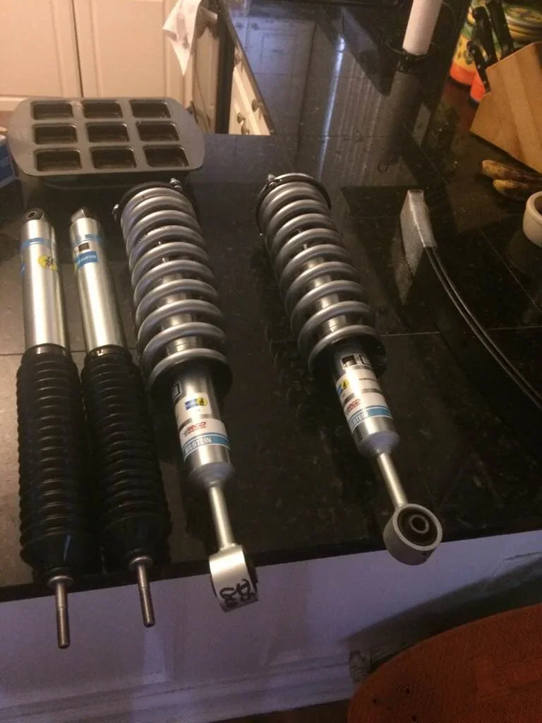

Yes ive changed a few and their always tight, put the top in first making sure the bolts line up correctly( so the bottom of the shock also lines up with the bucket mount) have a friend stand an the brake rotor and push down with all their weight while you slide the bottom of the shock into the mount. Could also use a pry bar between the lower control arm and the frame to pry the arm/ shock mount down to fit it. Its a pain in the ass if youve never done it. ImageUploadedByTaco Forum1457478693.530634.jpgImageUploadedByTaco Forum1457478704.398785.jpg
Mine is a bilstein on eibach coil, much harder to stuff in there than stock but same technique
