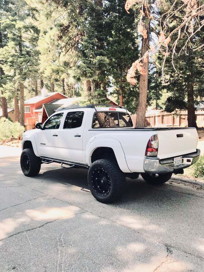

    I’m picking up the new to me Tacoma tomorrow. Now I’ll have to decide if I should change the lift to a 3” or change the gear Ratio. I think the price will be similar although new wheels may add to the cost. IMG_0925.jpg

    Congrats. Depending on how it's lifted, you may not be able to go back down to a 3 inch lift.

    It has an Ikon 5” lift. Yes the frame was modified and it had the drop
    Crossmember. It tracks perfectly so far. I got it for a really good price so I have room to spend if I need to.
