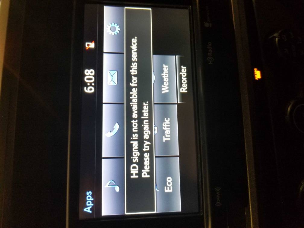

    Can somone explain to me why my traffic and weather wont work? When I first bought the truck the weather did then shortly after it stopped? Or has anyone else had the same issues 1547075352414.jpeg

    I have had mine do that, but I figured it was because I was way out in the county. After awhile it comes back on. Don't know if that is it but I have experienced it.

    Your cell phone isn’t connecting? Just a guess.

    The HD comes from radio stations pushing out the HD signals. Where I live the only HD stations are more than 50 miles away so the weather and traffic signals aren't strong enough to register on my radio even though I occasionally get HD music signals. Not to mention they are too far away for me to give a sh*t about their traffic. Hope this helps.

    Use the entune app. Sign in and connect it to your head unit and it will work.
    It will pick up sometimes off of HD stations but they are only in urban areas.

    Thanks this helps alot I do live in a pretty rural area with only 1 HD radio station and its weak most of the time I'll try the entune app

    My 2014 goes out and won't connect to my phone it comes back on after a few days called Toyota once they sent an update for my entune once it was a pain to upload but it got it online again best of luck.
