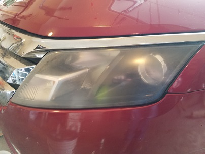

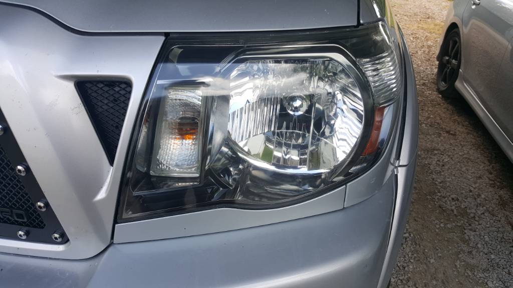

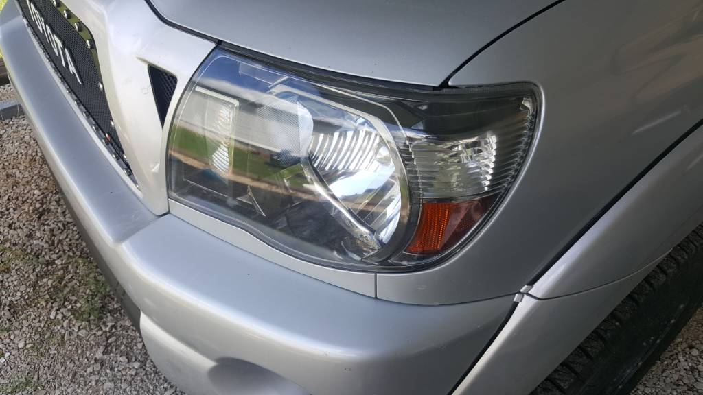

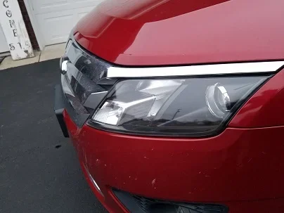

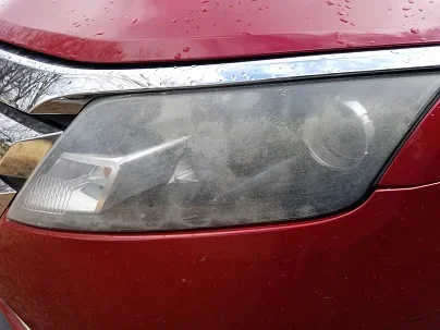

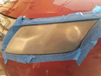

Alright, so I finally got around to trying this restoration kit.
Before:

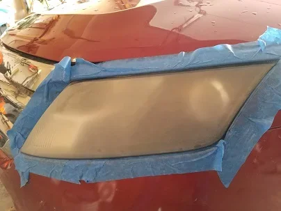

After step 1 (Sanding with 400 grit sandpaper (approx. 20 minutes):
After step 2 (Sanding with 1000 grit (approx. 5 minutes) then with 2000 grit (approx. 5 minutes):
After step 3 (applying the clarifying compound (approx. 5 minutes)):
Finished Product (after applying the UV protectant coat):
In my opinion, this kit is worth every cent of the $18 that the kit cost. If I have to do it again in 6 months, then so be it and I will order this kit again.......I can buy a whole lotta kits for cheaper than replacement housings. Anyway, I don't mind blowing a couple of hours in the garage adding to my beer can collection!
