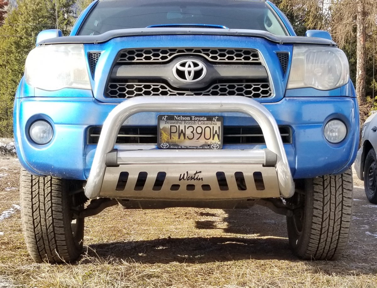

    Hi All. I've got a 3" Pro comp lift kit and ever since it was installed I've noticed an alignment issue in my front end. Please see the attached picture and you'll notice that my front camber is off. I've had it into an alignment shop but they says that they've adjusted it as far as it will go. I'm not sure if I believe them or not which is why I'm asking here. Do I need to buy special parts to fix this issue?
    FYI these are just my winter tires.

    New UCA’s are probably needed. You might be just past the OEM ones for an alignment. TC makes good ones.

    OK. I might opt to see if the alignment shop will change them since I'm assuming it will need to be re-aligned after.
    I've noticed the truck tends to wander since the lift was done. Perhaps this will help?

    I have a 3" lift and I have stock uca one thing I seen my alignment guy do along with aligning is mess with the caster Wich I believe fixes that anyone got input on this?

    Should help once you get can it aligned.
