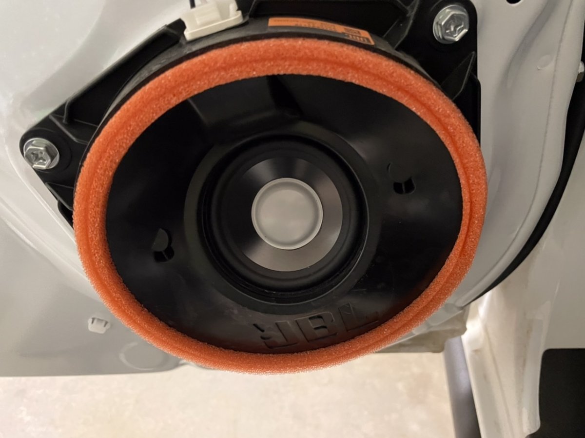

  8. noveske
    noveske New Member
    [​IMG]
    This stuff arrived. Now just waiting on the adapters, silicone baffles and connectors to try and avoid cutting the factory wiring. Hope this isn't a thread jacking. Not my intention. Just don't see many JBL Premiums being upgraded. I know that it won't be a crazy improvement, but I'm hoping for a little clarity and less distortion. Also have a bunch of NOICO sound deadening liner around. Planning on giving this all a go soon. Waiting on the stuff above and door panel clips. Ordered some just in case and also hoping it would keep things more secure. Just have to remember to swap the door handles out for all black as well. Just gotta knock out the roof rack install first. I know there is a guy on TW that did the same setup but with different Polk sub. I think he also went with GX602 and GX302. I believe the GX628 and GX328 are just the updated versions.
