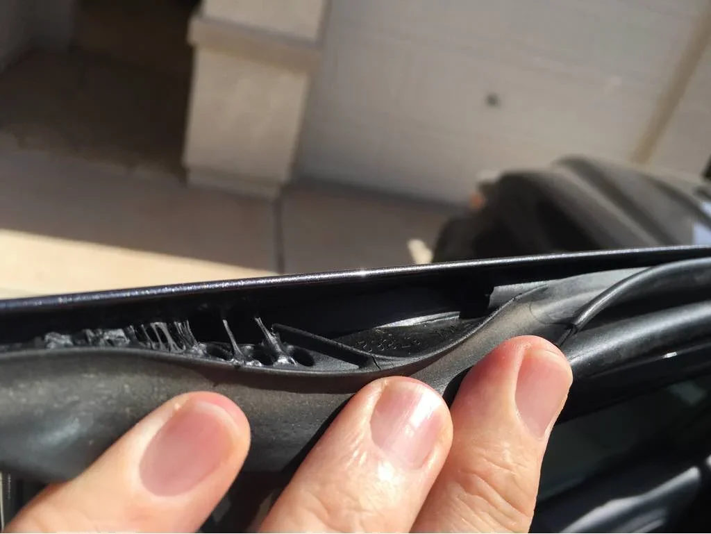

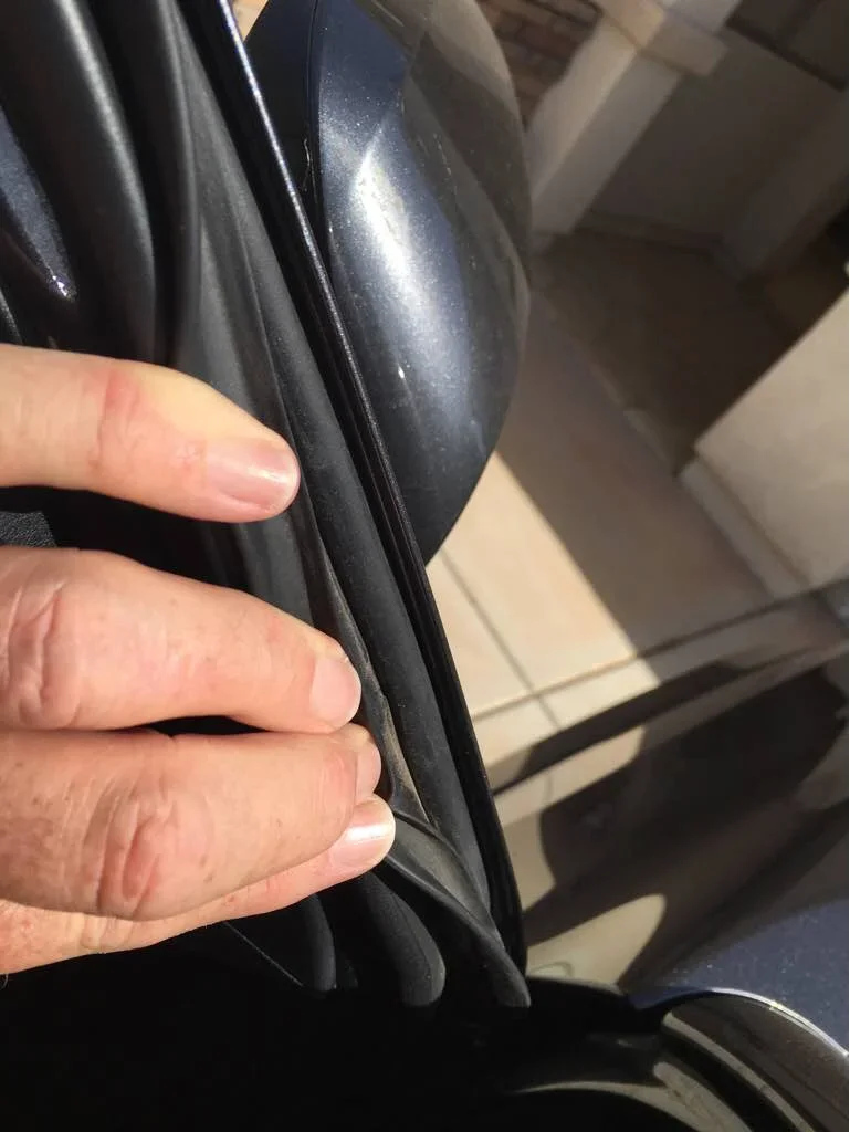

Can you post a pic?
ImageUploadedByTaco Forum1469291819.924708.jpgImageUploadedByTaco Forum1469291848.628771.jpg
Hard to see but a hard rubber cylindrical stock glued into the upper fold of the front door seals
