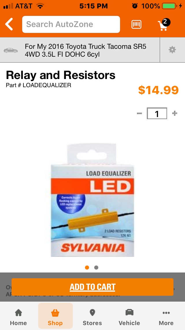

  10. B-RI
    B-RI Well-Known Member
    I used the sylvania resisters and they work just fine. I bought them at Autozone but I’m sure you can get them from other places as well.
    texasred likes this.

  17. ToyTaco04
    ToyTaco04 Member
    This is right. You just need to stick a resistor inline with the LED to add a little more load. You don't need to spend the money on expensive Sylvania branded resistor. A resister is a resister. You can buy a 6 ohm one for $2.
