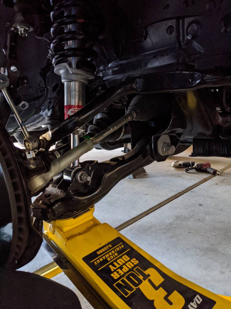

Honestly what I ran was Eibach stage 1 pro lift kit. Has adjustable eibach strut assembly, some great quality eibach springs, rear shocks, and you have an option of an adjustable UCA. The only thing this kit lacks is a leaf spring. I unfortunately had to run the stock springs due to the spring compressor not working that well. Beyond that this kit gives you 2.5 - 3 inches of lift. Downside is the rear will sag. I suggest an add a leaf or complete replacement of the leaf springs to accommodate for the lift. Rides awesome and so far no complaints. Best thing was the price at around $650. The UCA however is pretty pricy so that's why it's just an option. Ignore the squatting of my truck it still hasn't settled yet. IMG_20191123_153445.jpegIMG_20191124_094117.jpeg
