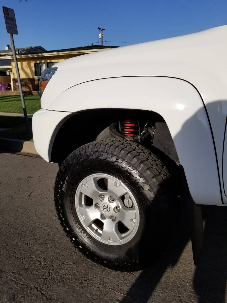

    Thank Bojangles, I was thinking about the tires but with the lift I don't know what tires would look good. Any recommendations? Right now I'm running these 20180411_180858.jpeg
  6. Bojangles
    Bojangles Well-Known Member
    What are those?
    I'd say find their weight...... Then look for another 16" tire that may weigh less and isn't a POS.
    I've been running 265/75/16 duratracs in load range C and they don't look odd to me with a 2" lift.

    Ya I'll check I think mine are 285/75/16
