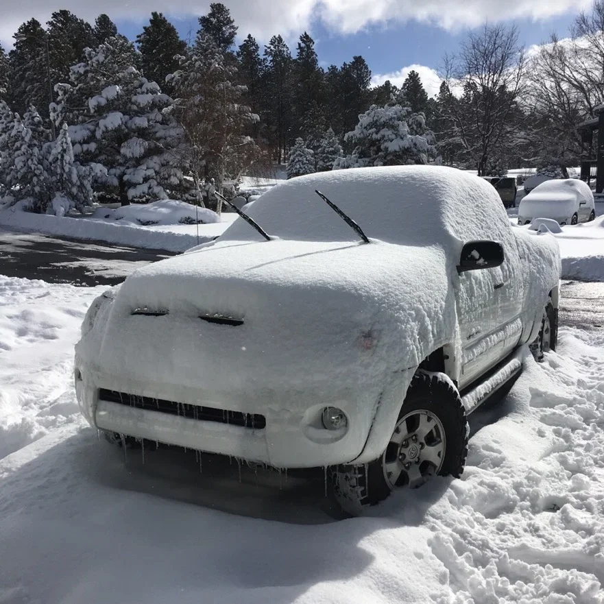

Just for informational purposes on different price points. I have had thes "Hercules Terra Trac R/S" before which are very reasonably priced. They are actually more aggresive looking mounted than they appear in the photo and they have a good bit of hum to them when up to cruising speeds. But they are fantastic snow tires and also do well on dirt/gravel and dry pavement. Wet pavement I would give them a middle of the road rating and they are on the soft side so alot of highway driving will wear them down. But if your on a tight budget and want something that looks good and performs decent they are worth a look.
