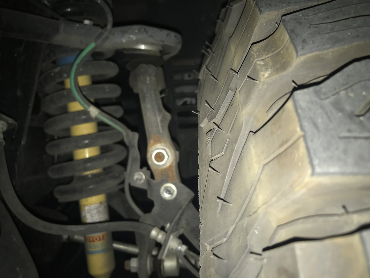

It's the upper A arm that I'm concern with. I dry fitted a 9x18 rim today and it looked like it was going to be too close. If I went with a more neutral offset I would be worried that the rubber wouldn't clear. I don't mind trimming the usual mudflap and inner fender that a lot of people have mentioned in other posts.
You’ll be fine then. I have 16x8.5” -6 offset with 285/75/16 and have more than 1/2 inch between the UCA and the rubber. The width of the wheel being 1/2 inch wider isn’t going to push the tire side wall in that much further it might be 1/4 inch closer at most. 66738863-14E3-43AA-89A2-3E15FF5DC80C.jpeg
