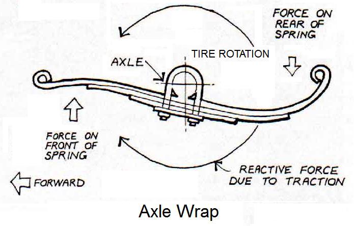

Sounds like axshole wrap
It’s this ^ happening and then you feel the spring pop the axel back into place. Feels like a bump after you stop. I found braking harder and holding the brake after I stop makes it worse. If I ease into the stop it doesn’t happen as bad or at all. Lots of talk about it in many threads on here.
