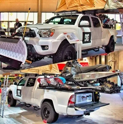

I really like the ride of my 2014 TRD Sport 4x4. That being said, on occasion I will be loading my 2012 SkiDoo summit X in the box for 200 miles drives from time to time. Realistically, 3-4 times each winter. The sled loaded with fuel and gear weighs about 530 lbs. With the tailgate down it will still stick past the gate about 23 inches. Other then these trips, nothing heavy is in the plans for hauling. Also the truck is used for on-road driving.
What is the best way to compensate for the extra load. I'm really not planning on lifting the truck more than 2-3 inches in the future.
