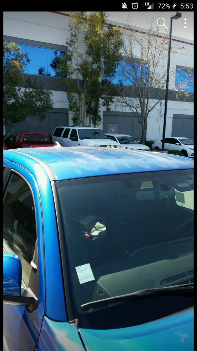

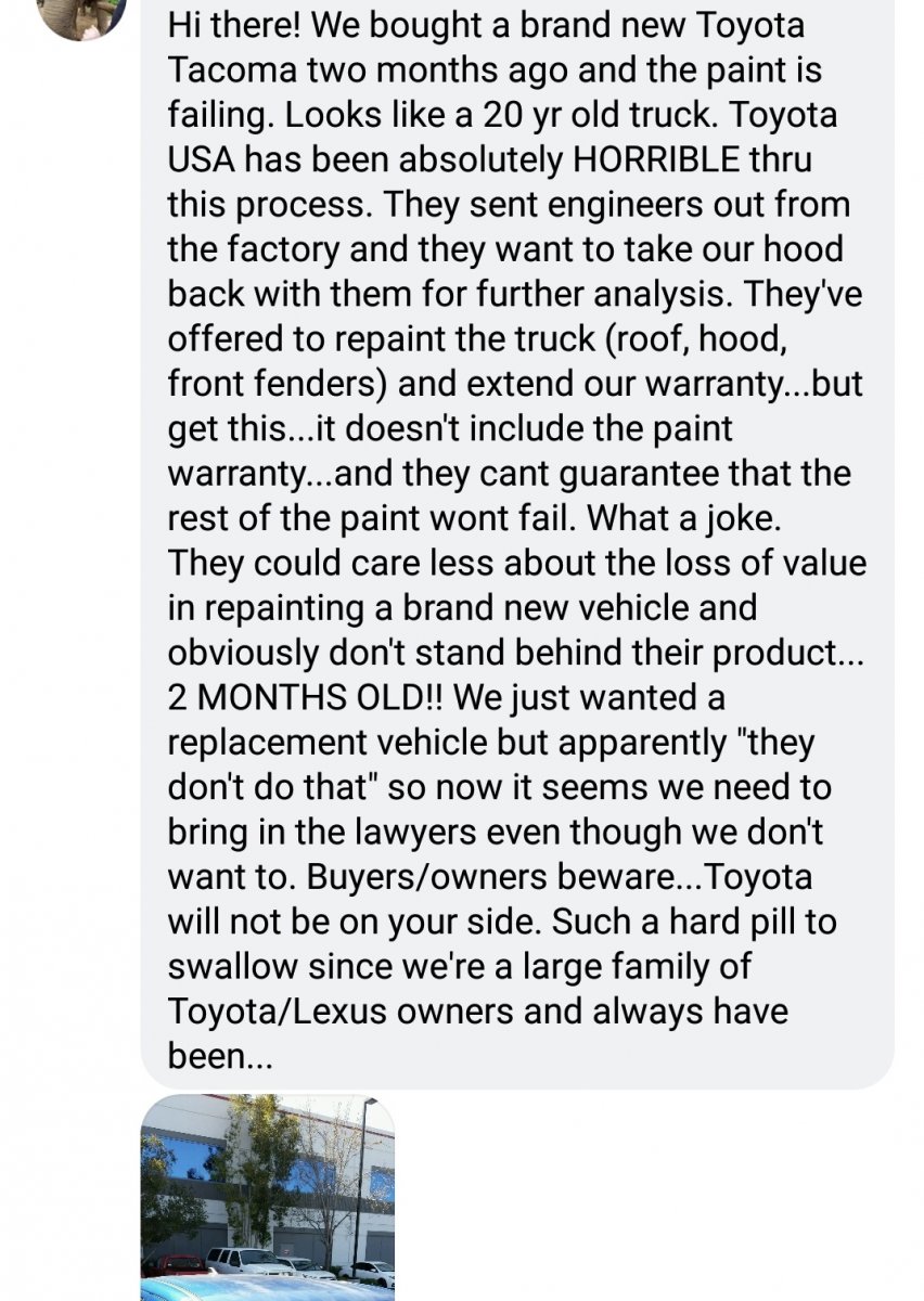

Wondering how many people have had this happen... I know Toyota’s paint hasn’t ever been the best. The 1st and 2nd gen 4runners and the 80’s-90’s pickups all looked like this after few years. Never in 2 months. I know Toyota Camry had some paint issues on the mid 2000’s and the 2007-2009 Tundra’s had paint issues due to having a single stage paint that had the clear coat mixed with the paint. This is either someone messed with the paint ie brake fluid got dumped over the truck or Toyota ****ed up. What a shame either way I’d be pissed. ECAEE16C-459D-4E99-8038-79A34CBC59E1.jpeg2319E1E3-D2E0-4ACE-8853-787A08F30007.jpeg

Wondering how many people have had this happen... I know Toyota’s paint hasn’t ever been the best. The 1st and 2nd gen 4runners and the 80’s-90’s pickups all looked like this after few years. Never in 2 months. I know Toyota Camry had some paint issues on the mid 2000’s and the 2007-2009 Tundra’s had paint issues due to having a single stage paint that had the clear coat mixed with the paint. This is either someone messed with the paint ie brake fluid got dumped over the truck or Toyota ****ed up. What a shame either way I’d be pissed. View attachment 15959View attachment 15960

The service manager won’t return my calls, but I have since returned for the body shop to take pictures. The service rep is suggesting a repaint. He refused to acknowledge the Toyota USA TSB re: wrap guard and insisted that wasn’t the issue.
I’m hoping the Warmer temps here bake out the blemishes in my paint and it’s over with.
I would find a small area and test it myself before letting them paint it. Seems like a ton of hassle for a potentially easily resolved issue.
Can probably even use a hair dryer on a small area and see if it improves. Can't imagine it takes a ton of heat.
I didn't even have an appointment with the Toyota dealer here. Just rolled in, they were like 'oh yeah, it's this issue. Simple fix'. Took it back, heated the hood, buffed it out, and I was out the door in about an hour. Been perfect since.
