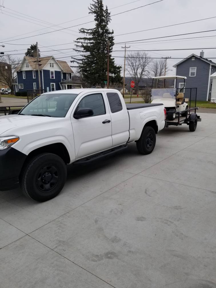

Has any1 tried painting there stock 3rd gen grill? I want to paint mine matte black but need to know what type of paint to get. I saw one parked one day and it looked good.
I used flexi-dip in the rattle can from Home Depot upon recommendation from here. Mine turned out a really slick, matte finish. There's a pic of it in here somewhere.
