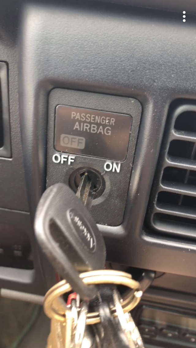

I have a 2004 Tacoma and the model where I can manually turn the Passenger airbag “ On, Off”.
Yesterday I was messing with it and as I turned it to the off position it then got stuck and will no longer turn
What I have tried...........
Getting a Copy if the original Worn down key
Getting a Vin Cut Key
Cleaning the lock
NOTHING WORKS!!!

Welcome to the forum. You cleaned the lock how?
Like @Bogunn suggested lubrication can help.
Sometimes wiggling the key and finding that sweet spot can work.
Not that you would want to but sometimes a new cut key needs to be sanded down just a little and polished you can use some 0-0-0 steel wool for that. Wipe it down good before you use it so there is no debris on it if you do try that.

Like @OR17TRD said, sand the key down some and clean the debris off. The old key may be too worn to turn the tumblers and the new may be too jagged.

Have you tried a little WD-40 in the key slot?
