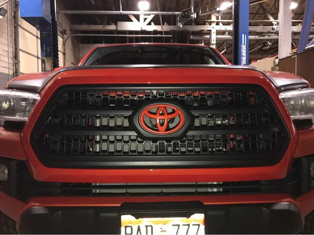

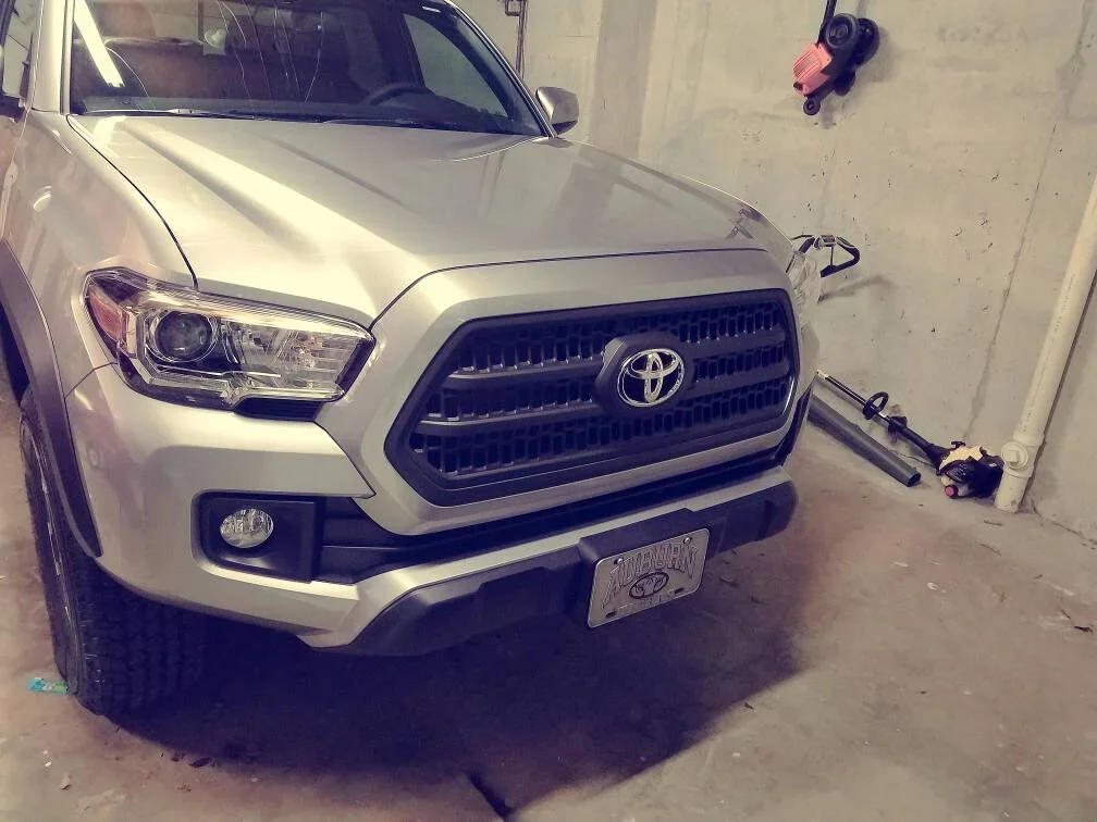

    ImageUploadedByTaco Forum1486951606.372513.jpg ImageUploadedByTaco Forum1486951627.143770.jpg ImageUploadedByTaco Forum1486951641.953630.jpg ImageUploadedByTaco Forum1486951654.385488.jpg
    Saved myself $500 bux by switching to plastidip. Now I just need to switch myself to single to save money for Valentine's Day.

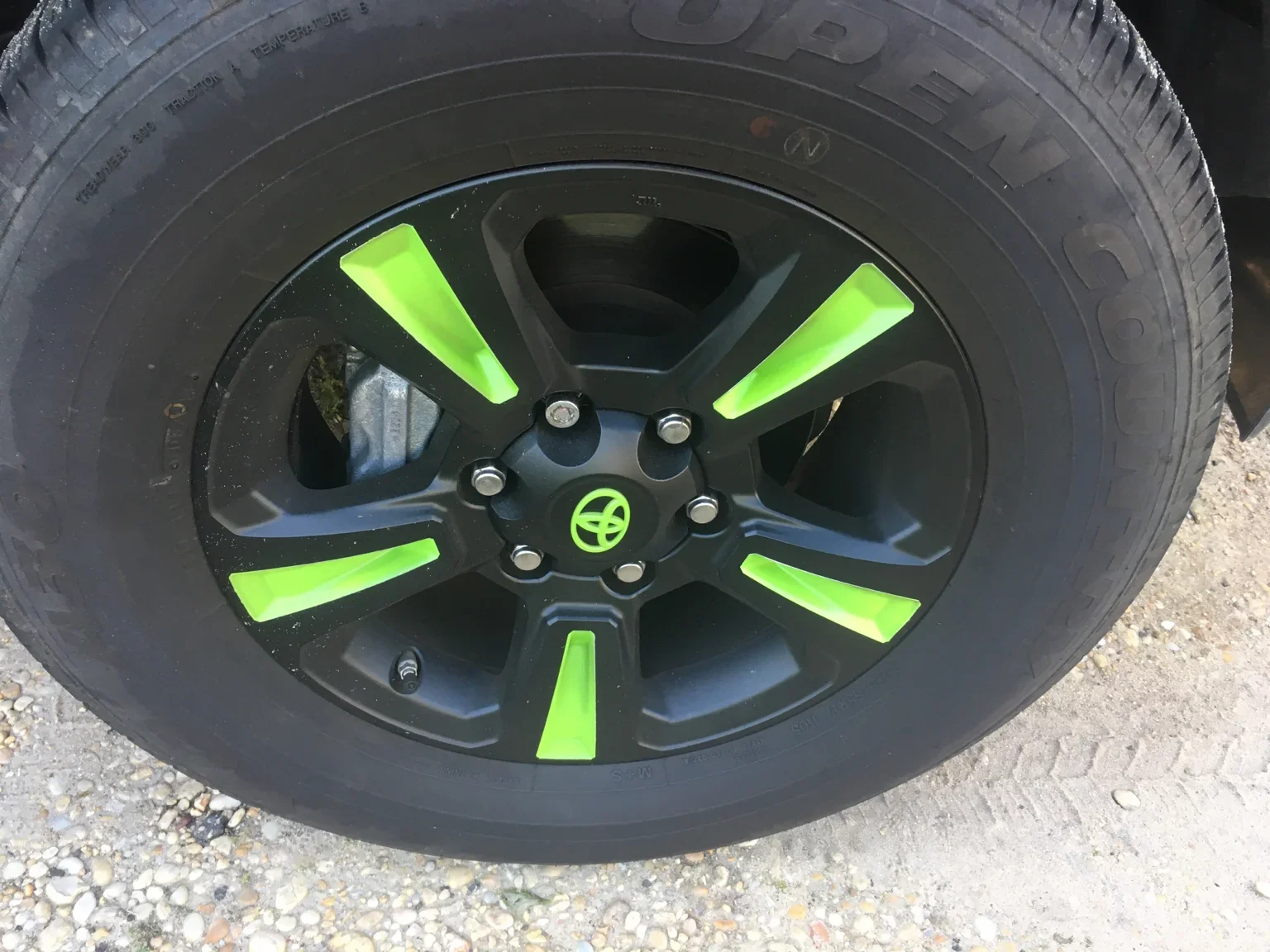

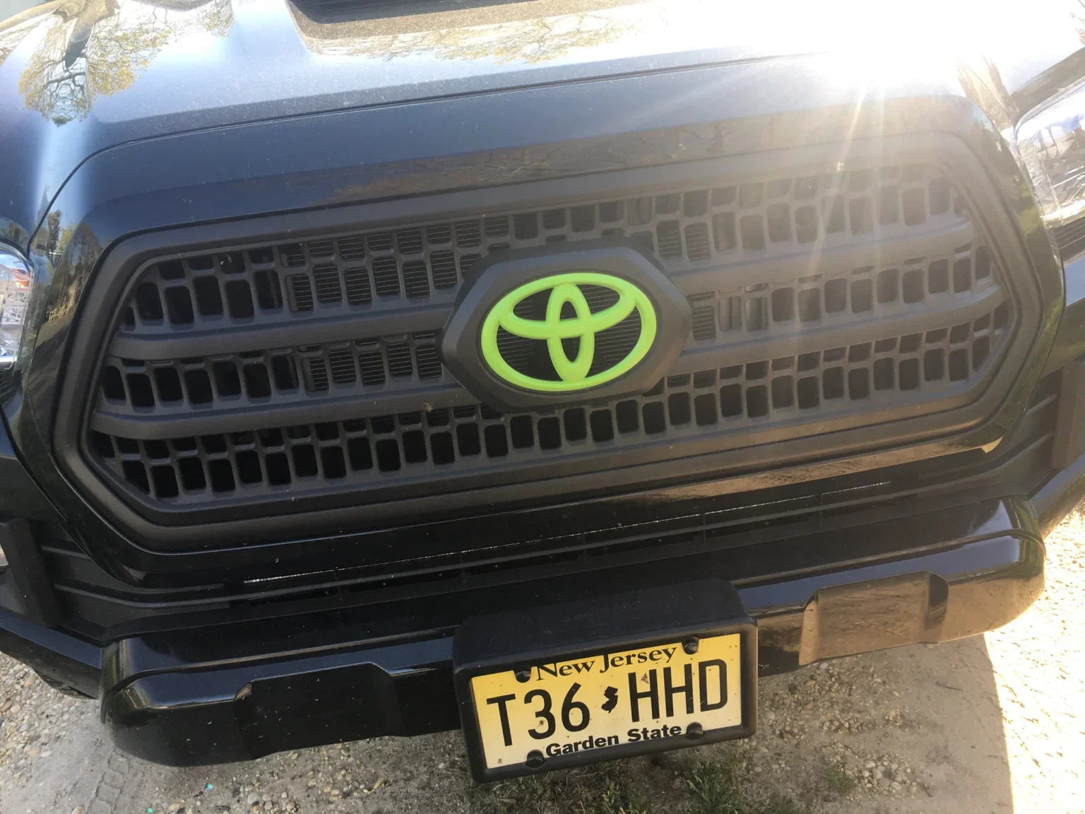

    Did the same

    I had the exact same idea. How easy was it to remove the grill?
  6. jcash
    jcash Member
    Not difficult at all. A couple screws and clips that's all.

    I actually used Flexidip. Same thing different brand. Got it at home depot for about $5

  11. tanderson5994
    tanderson5994 Member
    What type of prep did you do to the grill before putting on the plastic dip?

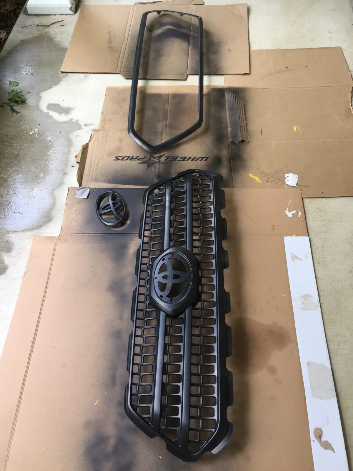

  13. Qwiksndmn
    Qwiksndmn Active Member
    Take it apart, use hot soapy water, dawn dish soap. Take your time and wash it good. I Hit a couple bug spots with brake cleaner.
  14. Qwiksndmn

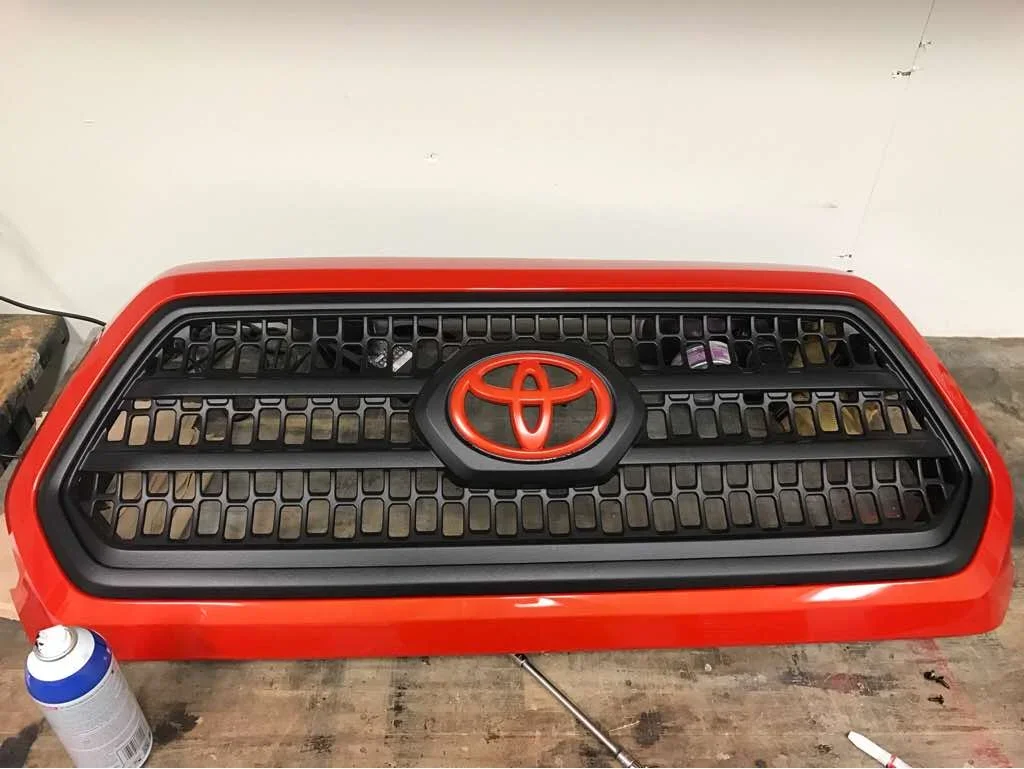

    Came out pretty good 6 coats and 2.5 cans.

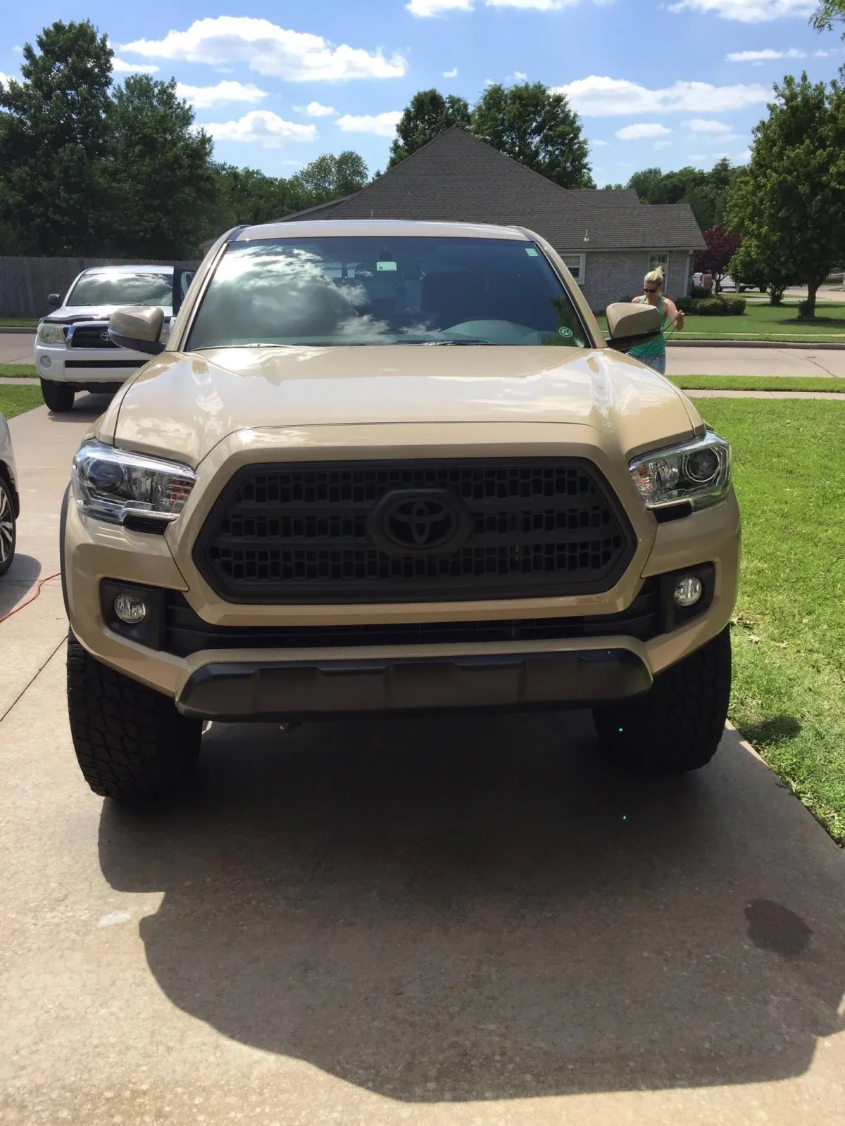

    Did mine about 6-7 months ago holding up pretty good other than one spot where a bug hit hard and I didn’t clean it off for 2-3 weeks IMG_0374.jpg

  17. greg8765
    greg8765 Well-Known Member
    be careful, the clips are quite fragile. doesn't take much to snap them off
