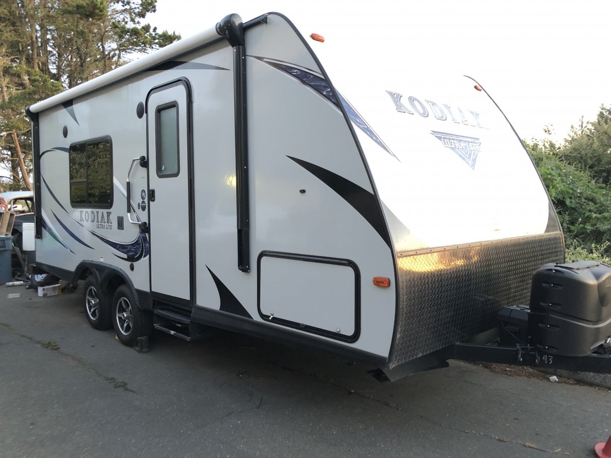

    Gears, gears gears....did I mention gears? Oh yeah...anyway, I do a ton of towing with both of mine. On the manual, well, drop gears and watch the tranny temp, but not much of an issue(yes, gauge added). On the auto...full regear, I went a little steep with 4:88 on 34s. But I will be running 35s after the Solo Motorsports install, so I geared once.
    Now for the tech stuff. Rated at 6000 lbs roughly. Depending on the package you have, they vary from as high as 6700 down to 5800 on the base model 4x4. Staying between 3-4000 lb trailer is excellent when you consider adding people and gear, ice chests and all that stuff. Obviously, choose a good brake controller, and the wires for it are provided when you bought the truck or, if used, cost $20 and use the existing plug if you have the tow package. Make sure any trailer rated over 1500 lbs have trailer brakes. This is the key, which I will explain...
    In the 70-00s, only a half ton (F150 or equivalent) could tow this kind of weight reliably due to the MASS of the truck. More weight on the rear axle, less chance of the trailer pushing you around without brakes. These Tacoma’s can pull, but let’s face it, the ass end is light. It can pull the weight, no problem, and actually has more power and in most cases more torque. But they are a small truck. So trailer brakes are a must above 1500 lbs.
    Lastly, 30 years towing gives me a lot of experience with all kinds of vehicles. These trucks are awesome, but slightly small. Mirrors are a must. If you only have some to no experience in towing such things, go to a parking lot and practice...a good driver in tow NEVER uses the rear view, only the side mirrors, even when the trailer is off...I hate having to teach this, but too many peeps never no how to back up or look at blind spots in tow. Practice practice practice...lol
    Sorry if it seems a lecture, but I do this daily...and yes, I commonly run a 14’ car trailer loaded to the dunes or a 20’ Kodiak Ultralight...

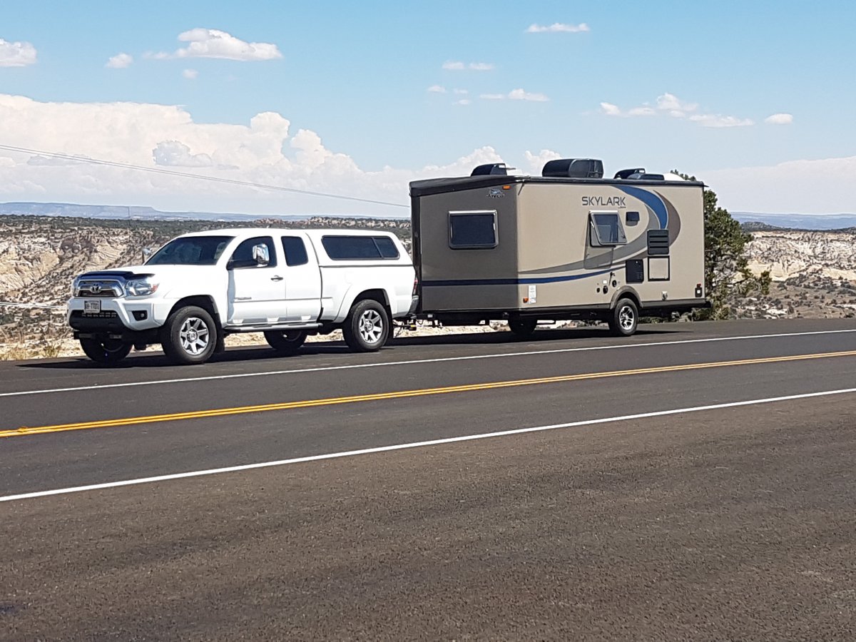

  9. Paulie
    Paulie Member
    Yes I pulled r 26 ft jayco to the Grand Canyon with my 08 Tacoma sport. But it was a manual and I did add helper springs

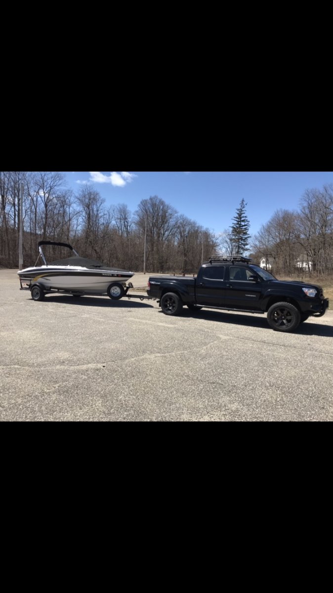

  11. lovemytaco35
    lovemytaco35 Active Member
    I’m pulling a 20 ft boat, about 4200 lbs with the trailer. Getting about 10 mpg. With the exception of steep grades, truck handles the weight fine.

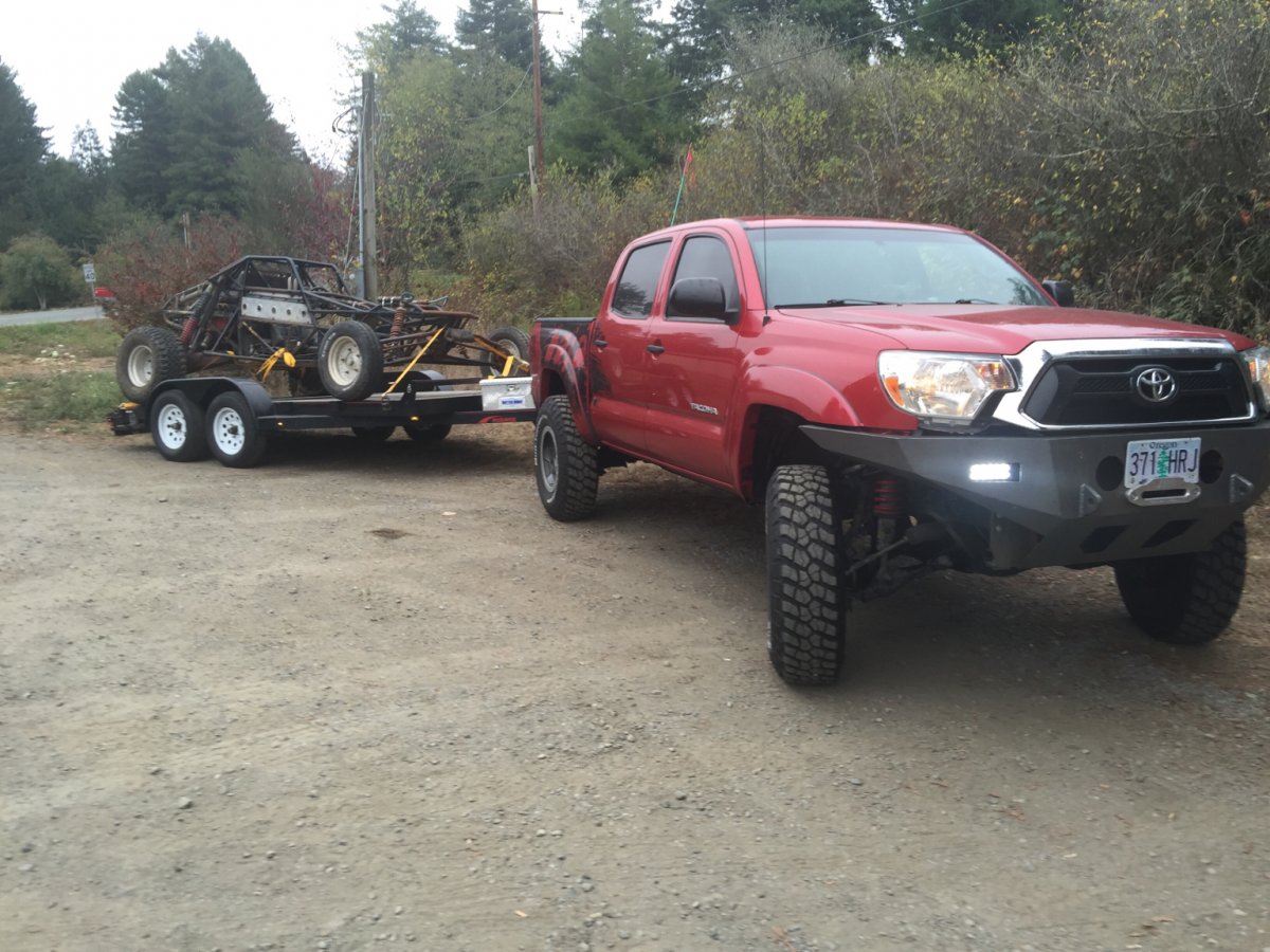

  14. Scuzzy
    Scuzzy Well-Known Member
    Nothing says please use the WD hitch like a 56 on the car trailer...lol

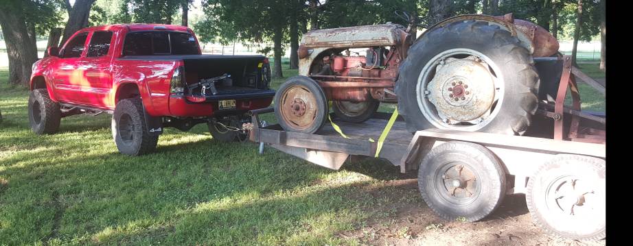

  15. OP
    taters95yj
    taters95yj Active Member
    This is the heaviest I've hauled with it. Heavy framed 16' tandem axle with a 40's model tractor and brush hog. It pulled and stopped pretty well for the short distance i pulled it (8-10 miles). But no highway driving and no idea on mpg 20171231_230754.jpeg

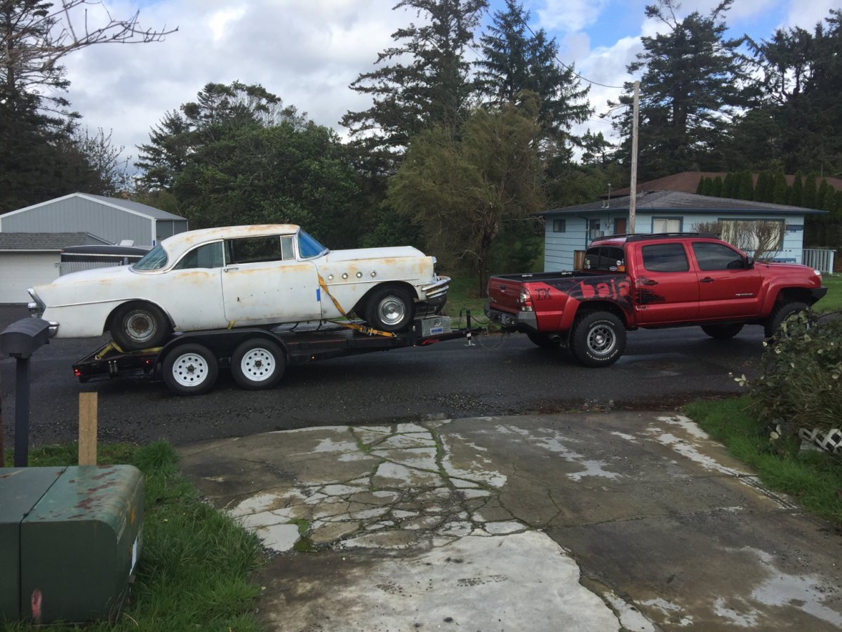

  18. OkieCowboy
    OkieCowboy Well-Known Member
    Now that’s some real weight. My grandfather bought one like that one only black. He drove it a number of years with pride.
    Grandpa would complain about how poorly it ran. My dad would bring it home and the mechanics would scratch their heads. Dad would fill it with Ethyl gas and make the trip back to the farm. It would run like a champ. A couple of months later it was running rough again. Finally discovered Grandpa was filling it with tractor gas. He ordered a storage tank just for Ethyl and it ran fine for 13 years.
