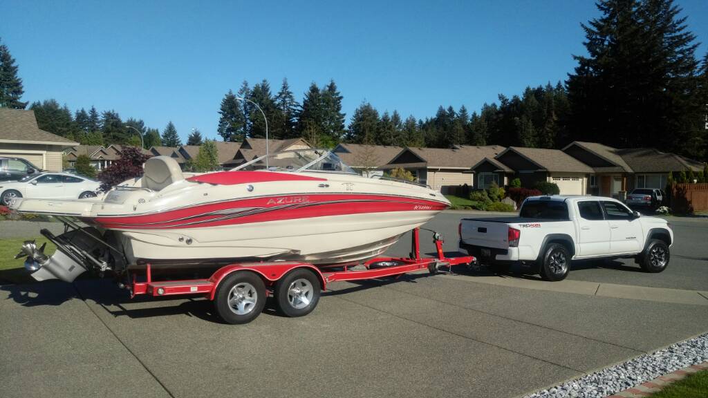

Tow 5700lbs with my 2017, it's been great!. No worse than my old gmc sierra 1500 5.3 litre. I would have no hesitation towing into the 6,000 lbs range as long as the trailer brakes are in great condition. IMG_20180512_1757541.jpeg
Tow 5700lbs with my 2017, it's been great!. No worse than my old gmc sierra 1500 5.3 litre. I would have no hesitation towing into the 6,000 lbs range as long as the trailer brakes are in great condition. View attachment 19243
