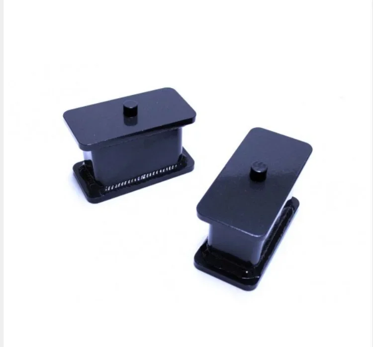

Like this. But in the size you need. These are 3". They are also angled for the driveline.
