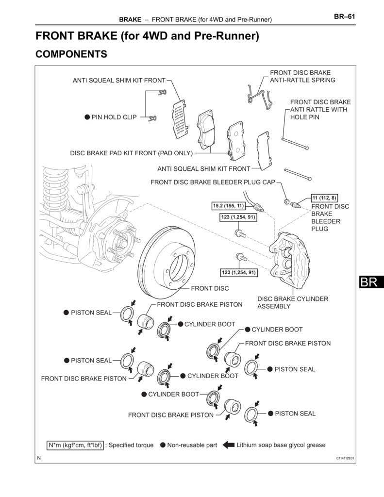

There could be a measurable amount of rusty buildup on the hubs behind these gen2 rotors
And the why they vibrate shimmy shimmy ya
Thats why you wire wheel any surface rust buildup from those hubs anytime rotors are replaced. You don't want any high spots on those hubs causing the rotor to have runout once their mounted.

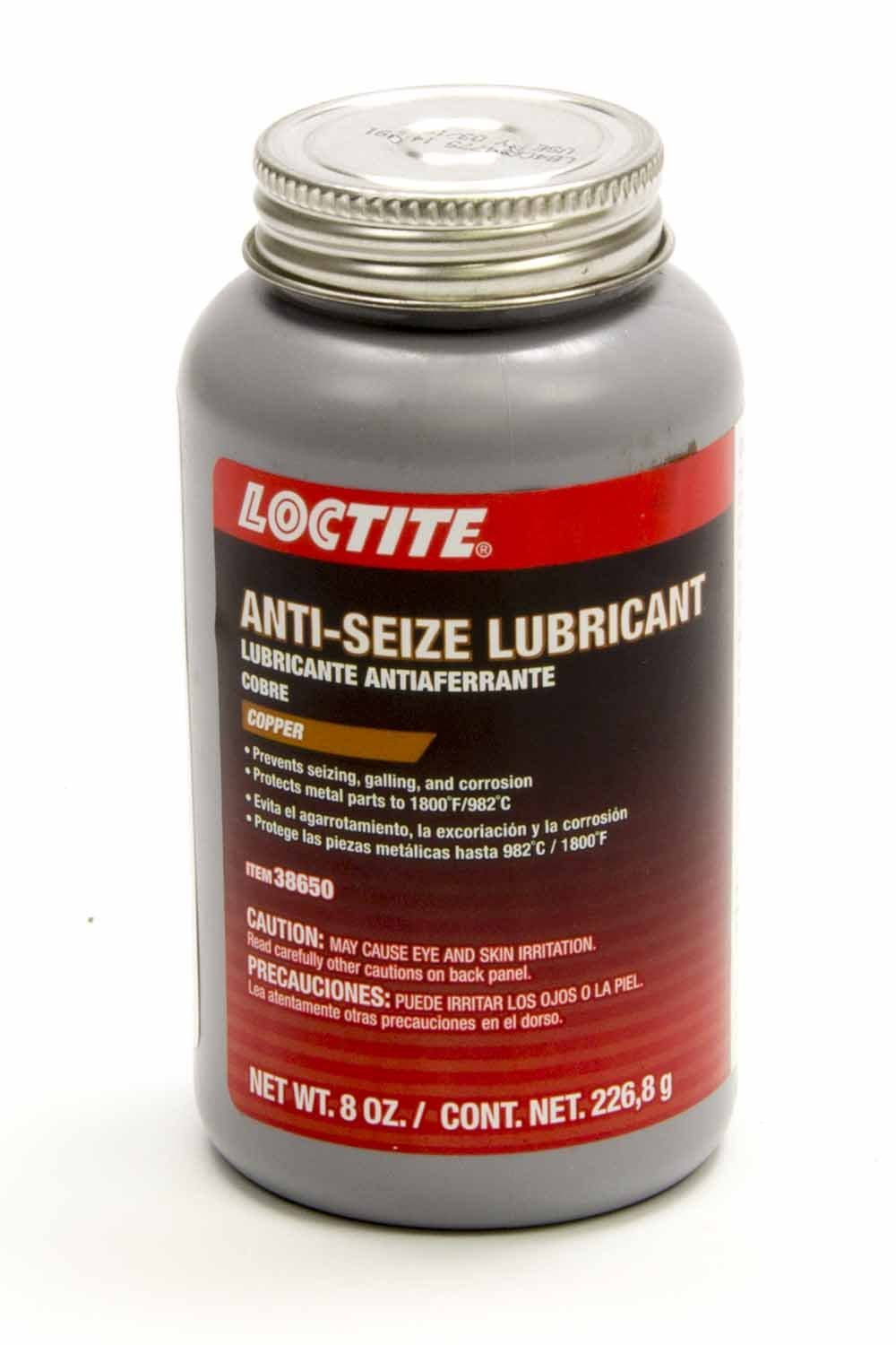

After you remove the schmutz from the hub and the inner surface of the rotor. Apply a light coating of anti-seize Cu based on one of those surfaces prior to assembly.
I use super lube never seize quite a bit. Keeps bolts for the dock sections easy to come apart at the end of the fall. Works great on those hubs that hold the rotors to. Just don't get any on the rotor faces.
could use that copper antiSeize on exhaust parts to keep them from corroding?
Good luck with that. I've tried all sorts of coatings as such on exhaust fasteners in years past...they all wash, or burn off in a short time. Using quality stainless fasteners seems to be the only golden ticket.
Any amount of water spray off the roads at highway speeds will blast it away.
