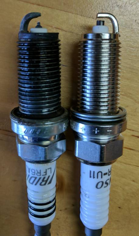

Well, I just replaced some Iridium plugs with stock Denso this past weekend. I found my old maintenance sheet, and it appears that I hadn't replaced them in 75k [emoji51] . While they might look better than copper plugs would at 75k, the truck did run a little rough, so if they do last longer, I'd be curious as to the real definition of "last longer". Stock plug gapped to .040", while the old Iridium gap had eroded to .070" (yowsa!):Your thoughts or pros and cons with iridium spark plugs?? Some say it’s not worth it and some actually say it LOWERS gas mileage.
4.0L with 112k on it.
Good note to self HahaWell, I just replaced some Iridium plugs with stock Denso this past weekend. I found my old maintenance sheet, and it appears that I hadn't replaced them in 75k [emoji51] . While they might look better than copper plugs would at 75k, the truck did run a little rough, so if they do last longer, I'd be curious as to the real definition of "last longer". Stock plug gapped to .040", while the old Iridium gap had eroded to .070" (yowsa!):
Note to self: don't put off replacing the plugs until the truck runs roughly! HahahaView attachment 17105
Purrs like a kitten now though!Good note to self Haha
