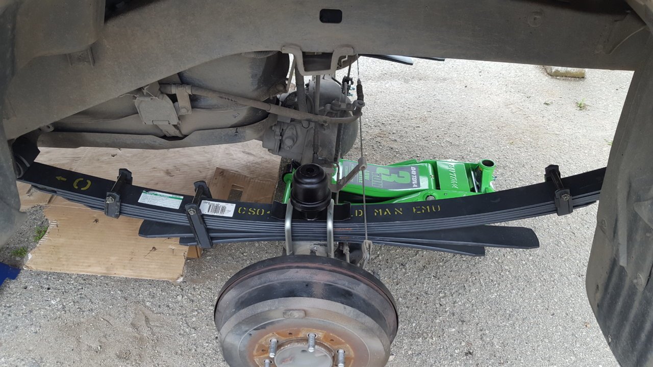

Toyota truck leaf springs are known to be weak. The leaf spring should have a bow, like a smile, when the truck is unloaded. If the leaf spring is flat or has a bowed down, like a frown, then they need replacement.
yes, i think they are looking rather flat, even more so with those new KYB rear shocks put on a couple weeks ago
If the truck looks level all the time with nothing in the bed, those leafs could be tired.

do i need to take a piccie of what my springs currently look like unloaded
