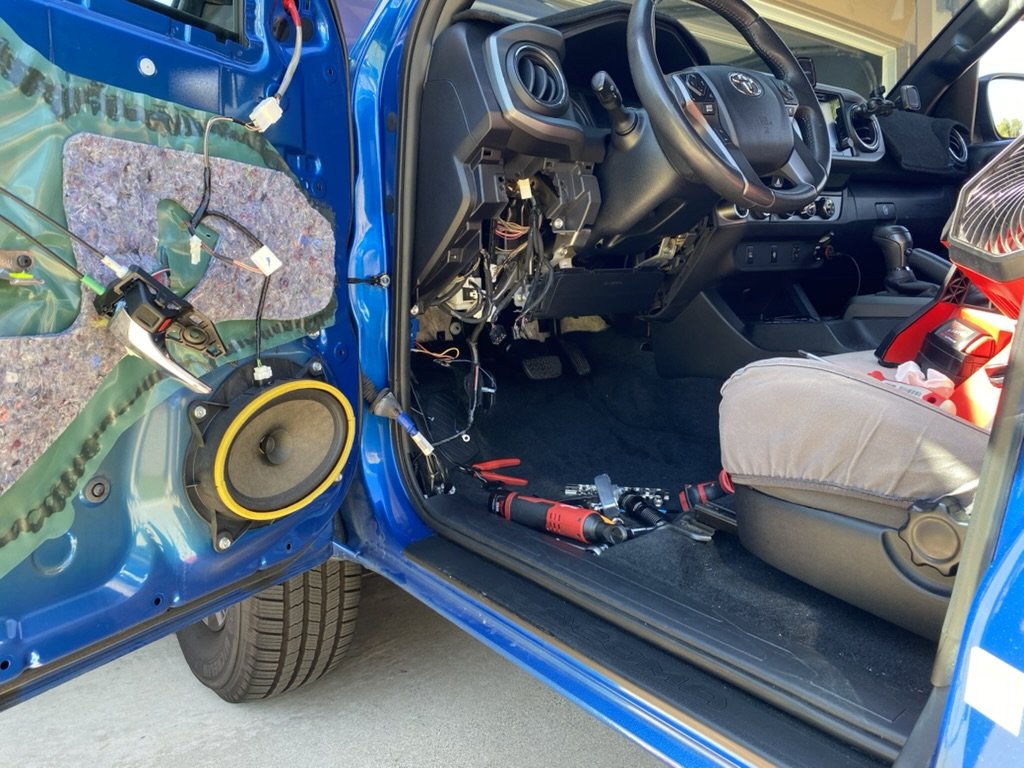

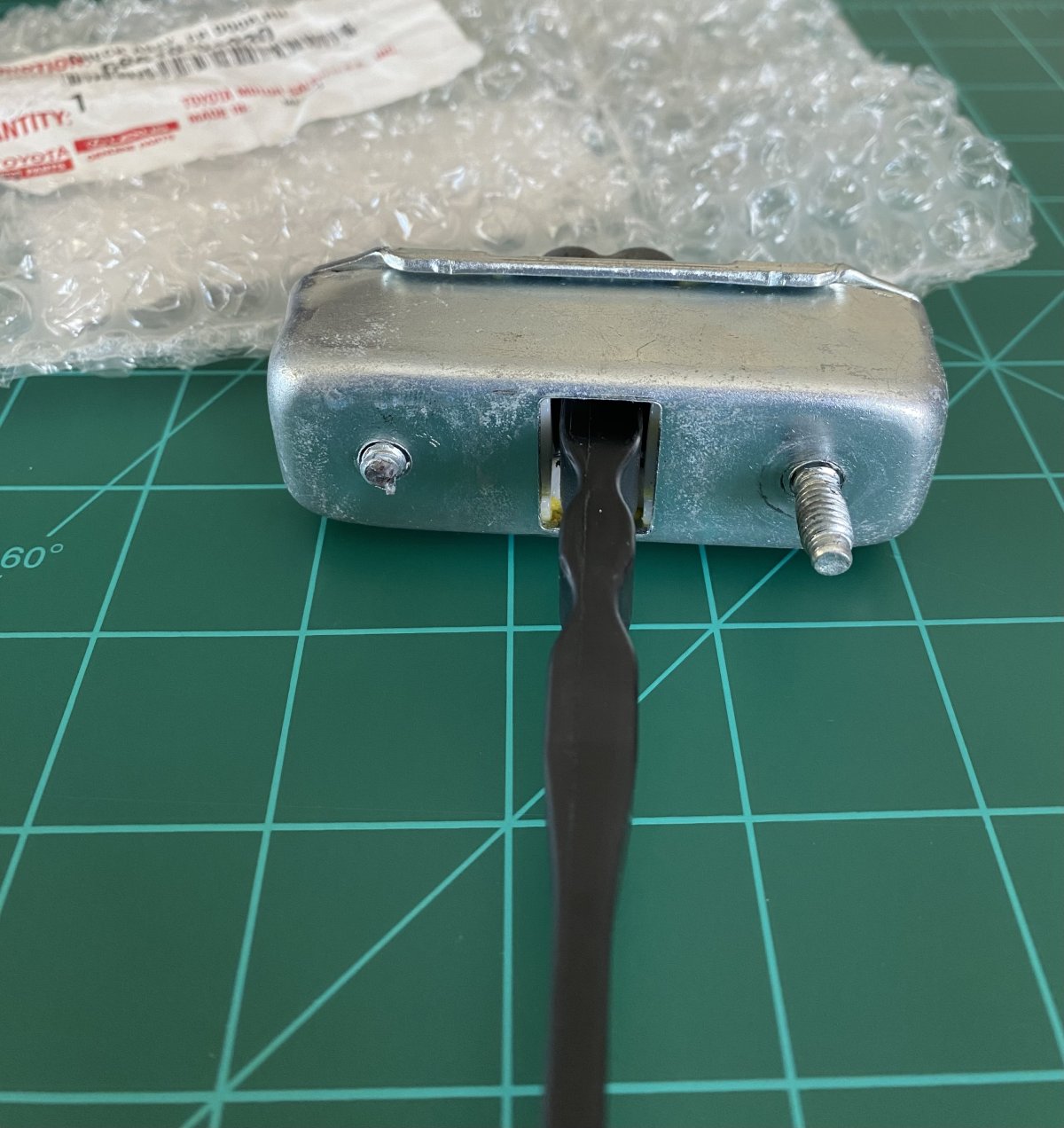

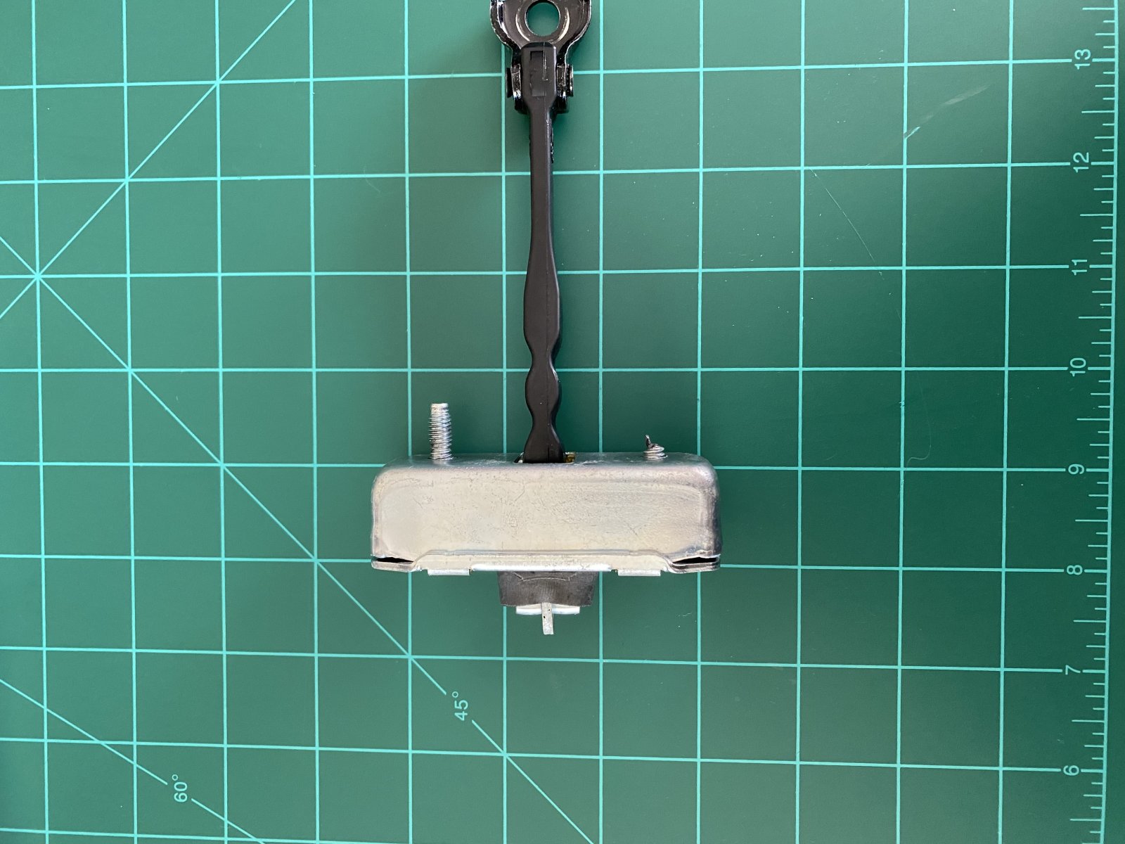

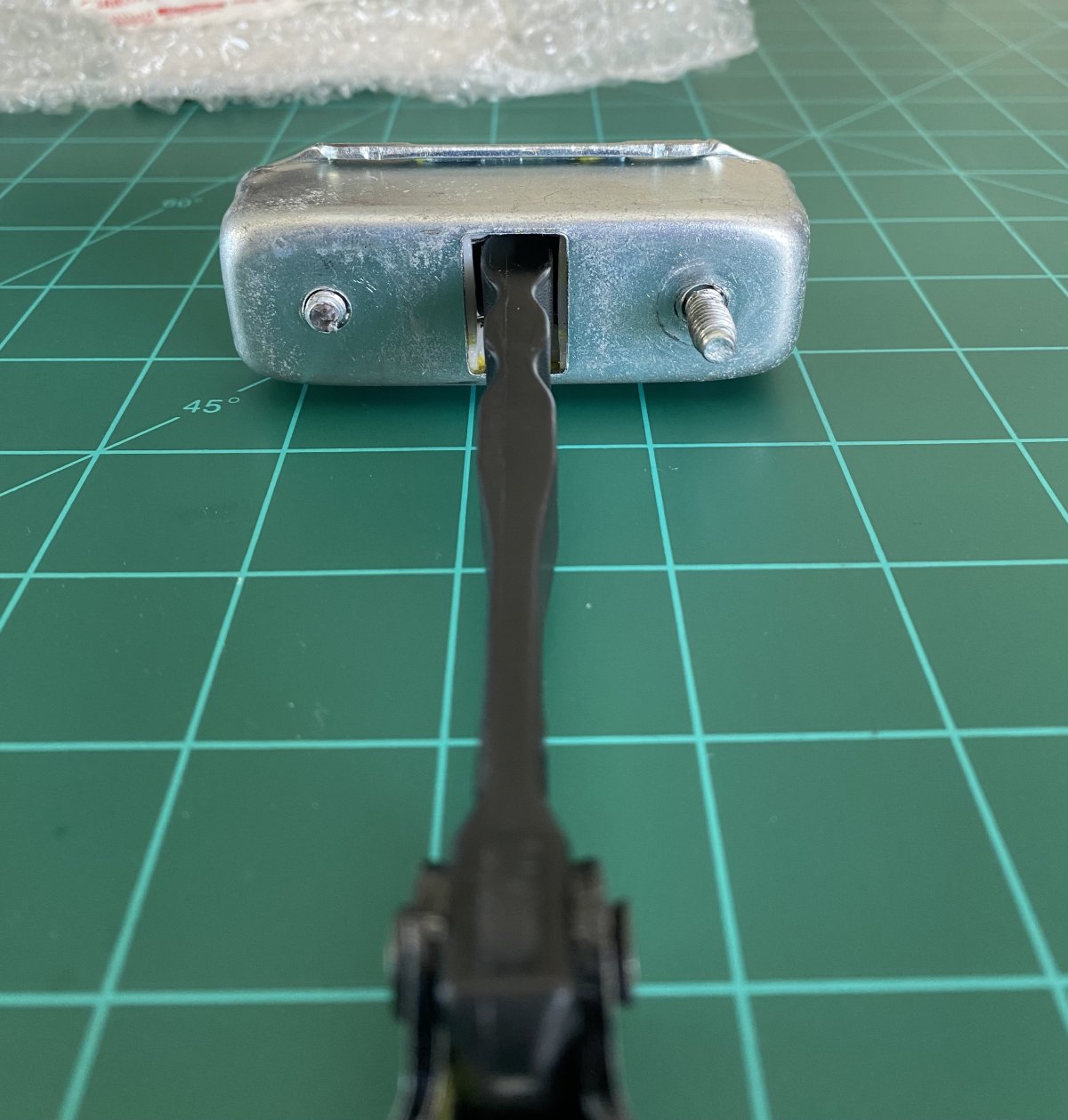

Here we go again. Pulled up the driveway after work, grabbed my lunchbox, opened my truck door and was greeted with the dreaded "CLUNK"! I sat there for a minute in disbelief. It can't be back, it hasn't even been a year! I grabbed my flashlight and there it wasn't. I was missing the bottom nut that holds the door check in place. So I searched the internet for an aftermarket part to replace a failed OEM one. NO LUCK, They do not make an aftermarket 68610-04030. NOTE: Amazon has a bunch of sellers that claim that their part will replace the OEM. DO NOT BELIEVE THEM!!! Their version is just a little bit longer and will hit your forward window rail when the door is closed. So anyway off to the dealer to spend another $100 (plus tax) on a part that I had purchased in July of last year. To be safe I replaced all the hardware this time around and gave the door check a healthy shot of grease. The job took a little over an hour this time and went a lot smoother. I hope this is not a reoccurring issue but only time will tell. IMG_0757.jpegIMG_0756.jpegIMG_0755.jpeg
