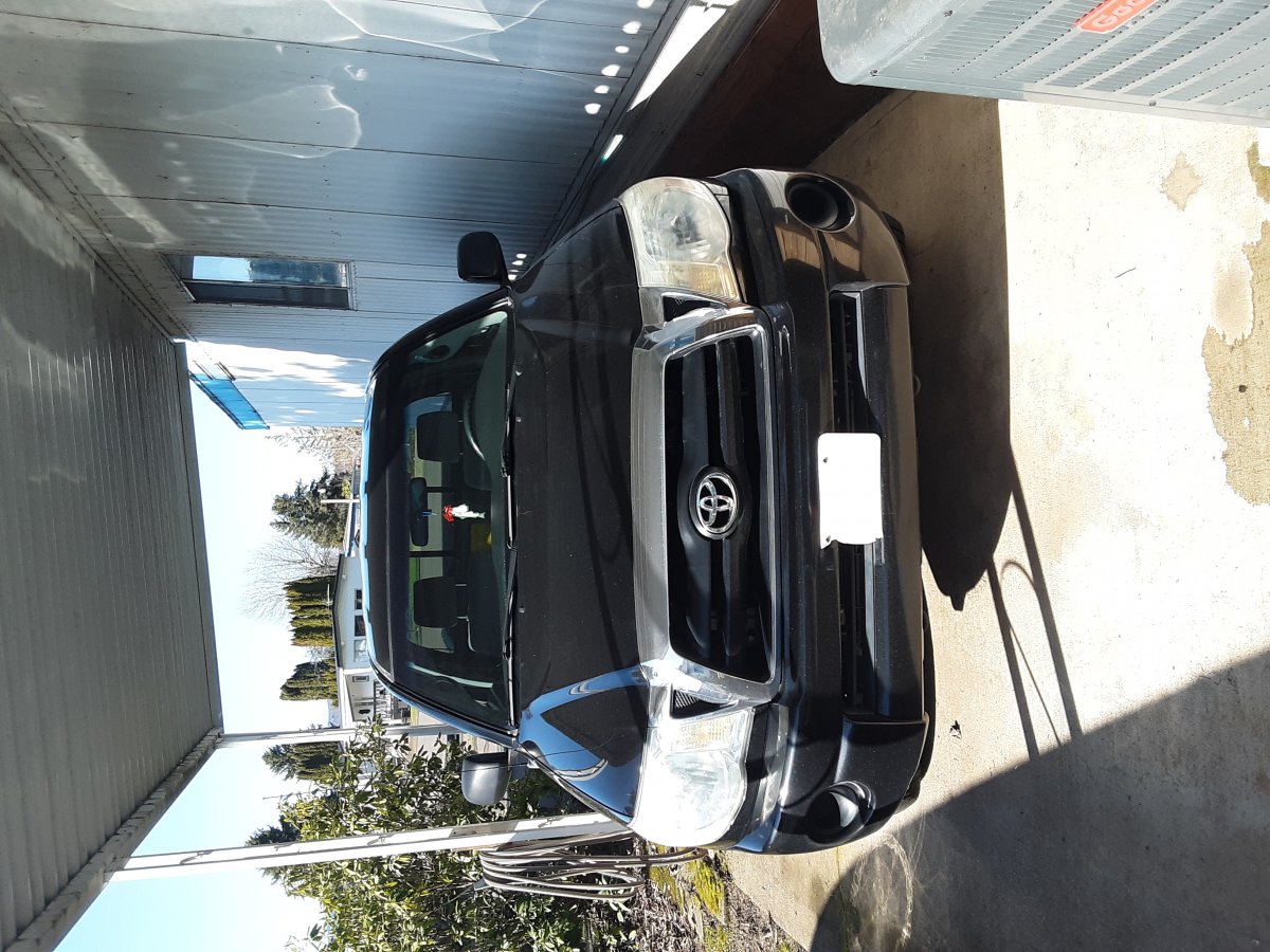

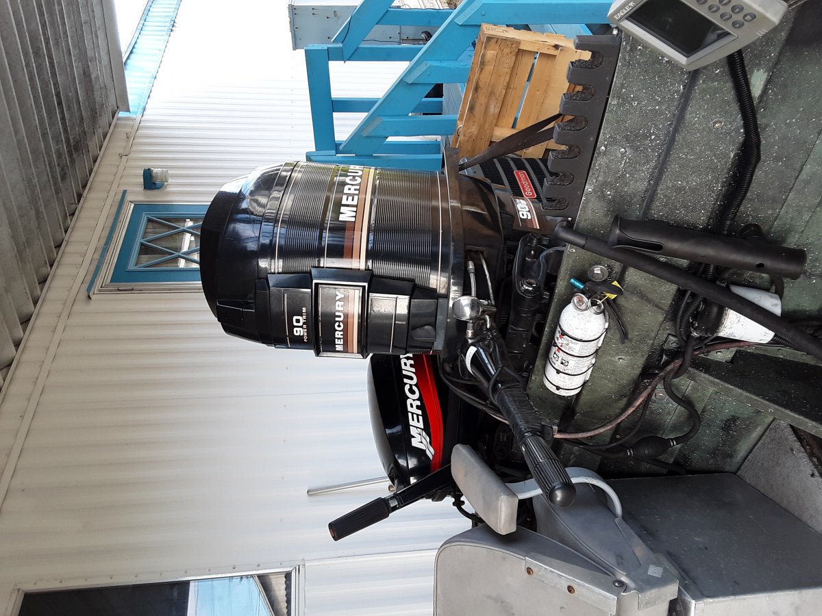

I have a 2008 Toyota Tacoma 4 cylinder automatic 4 speed transmission, and I bought an older boat. I towed it from Seattle to west of Portland the only problem I had was going up hwy 26 (steep hill) I could only get the speed up to 50 miles and hour. The boat weighs about 1700 lbs. Do I have a problem or is it normal on steep hills with my truck?
Thanks for any help with my problem Dave.
