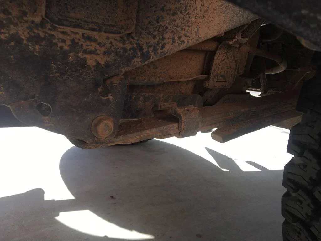

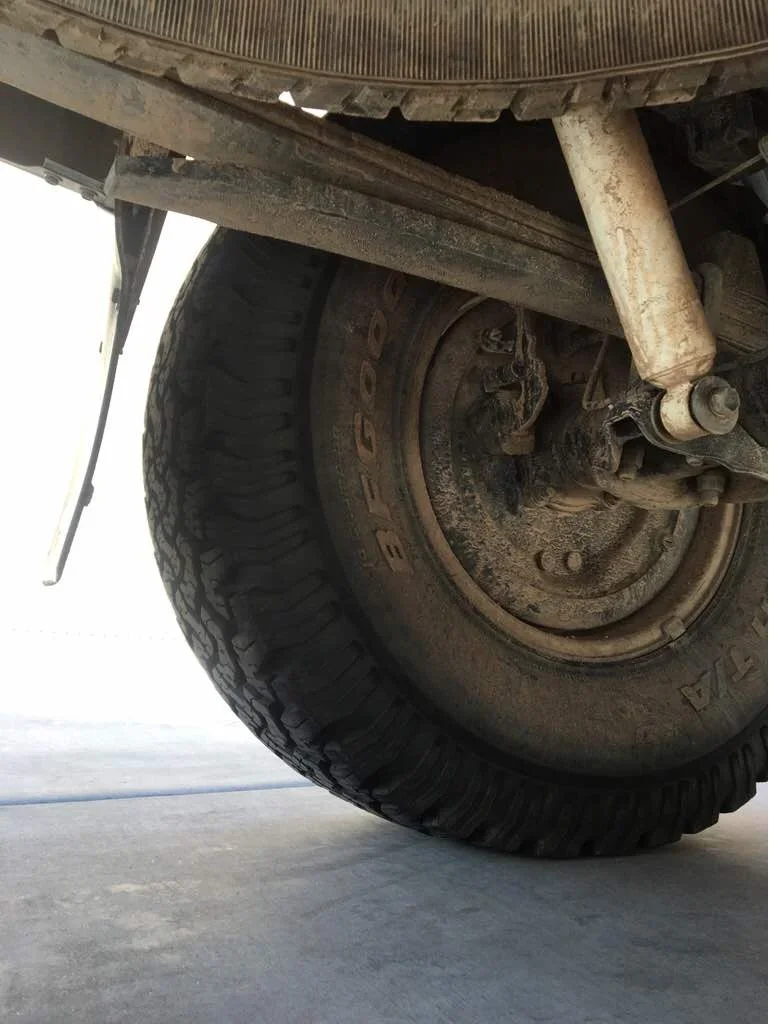

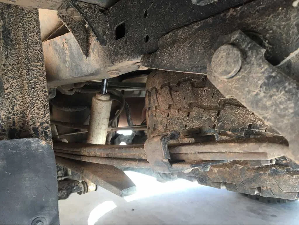

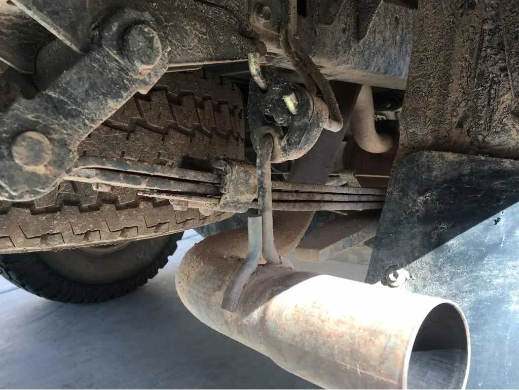

Well I looked at the axle and leaf springs. The leafs look pretty worn. One of the clamps that holds them isn't even on all the way. It only makes the clunk when I stop quick and then let off the brake. No problems apart from that. Then I tried putting the truck in neutral and then braking hard. No clunk or thunk at all.. If your braking normally without it in neutral, and put your hand on the shifter handle in the cab, you can fill it jolt. I'm still not sure exactly what it is. Here's some pics of the leafs.
Hey Kinghailfire,
I am sure you are getting pretty frustrated with trying to find out what is the cause of your clunk. The first thing I would do is completely service the automatic transmission. From your last post, it sounds like you narrowed it down to the transmission. I also have a 1999 with a 3.4, but mine is a 5-Speed. Once you service the transmission, you can then see if the problem persists.
Good Luck.
Paul
