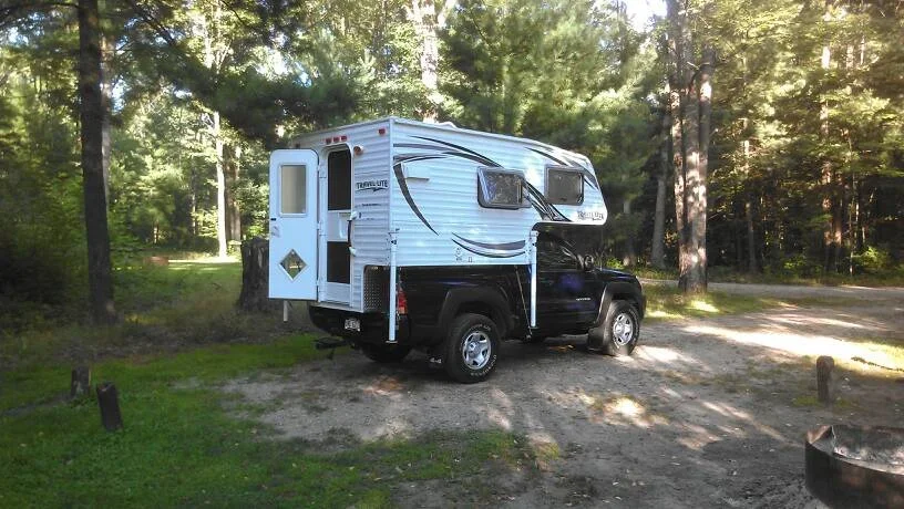

I decided to go the truck camper route instead, don't need a lot of room. Camper is made for mid size trucks, weighs in at 1100 pounds empty, well within payload capacity.
