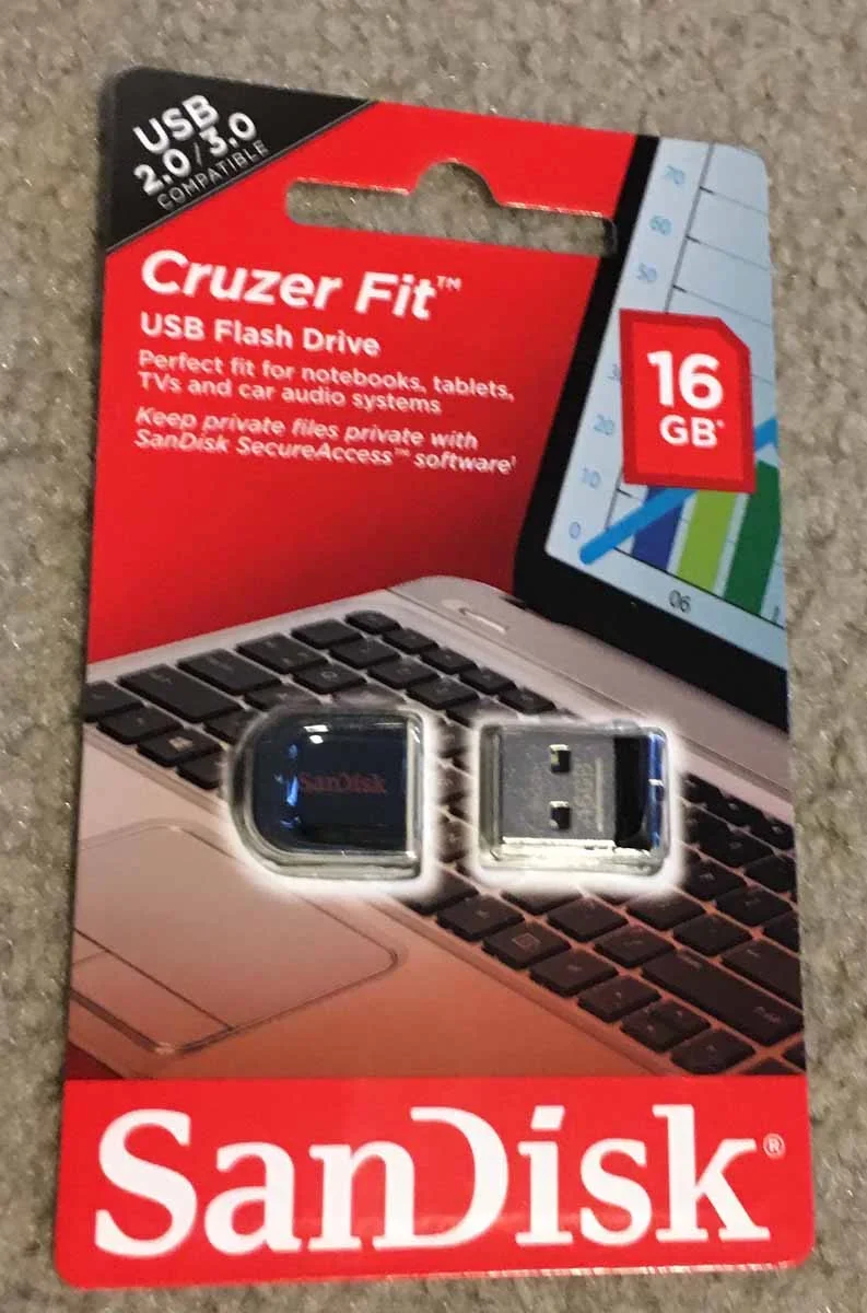

Does anyone know what size USB does the Entune system read? I have a large old huge stick and it played songs from it just fine. But I got a low profile 16GB stick so it would not be sticking out of dash and it does not seem to work formatted with Fat or Fat 32.
