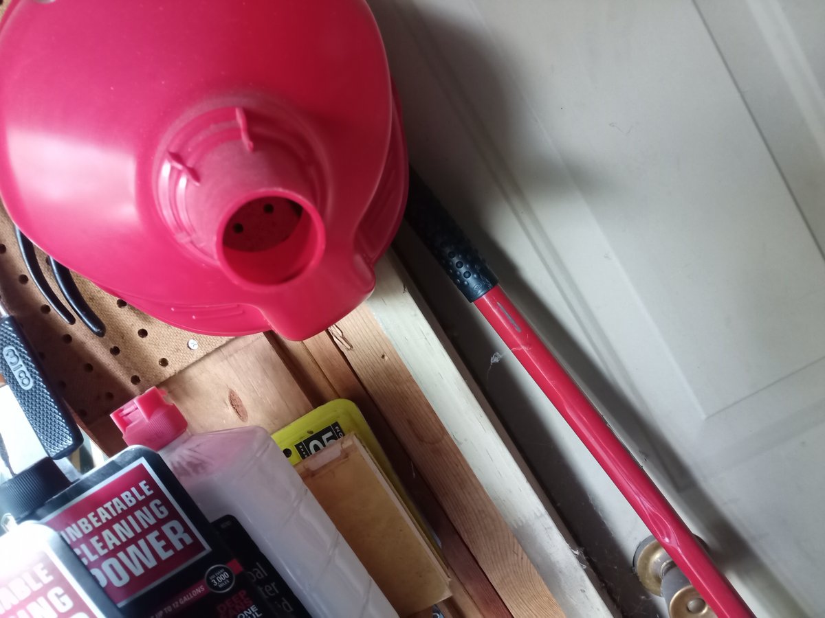

I took an old empty S100 plastic cleaner jug and cut a 1/3 off the lower end making a funnel out of it. Worked perfect crammed into my old tundra oil fill spout. Hopefully it'll work the same for the tacoma
