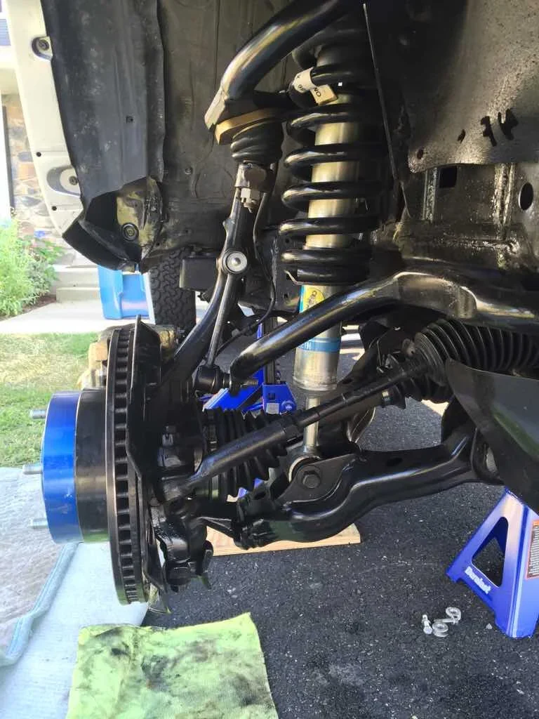

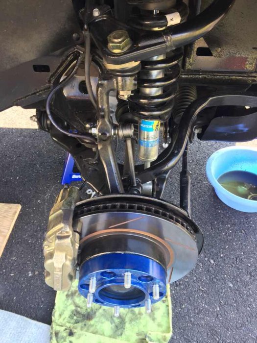

Got 2" on my taco & ranger both are daily driver, almost daily (taco, ranger & beemer motorcycle). Pro - look nice, lowered center gravity( 4" wider track), & doesn't look loke the other Taco parked next to me at work.
Con - take longer to replace the brake rotors (dont replace often anyway), 12 extra lugs nuts to do the rear brakes (again how often do you replace the drums), suppose to shorten the life of the bearings & ball joints (those things doesn't last forever anyway), & lastly dirty the side of the truck.

Make sure you get Toyota specific hub centric wheel adapters, also using the right lugs. you should be using et style lugs on the adapter and on your aftermarket wheels
