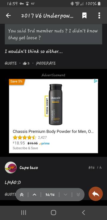

You said 3rd member nuts ? I didn't know they get loose ?
Take care of your chassis fellas...
[emoji23][emoji23][emoji23]
I actually use this powder btw... and it's awesomeness... lolScreenshot_20200420-165935.jpg
