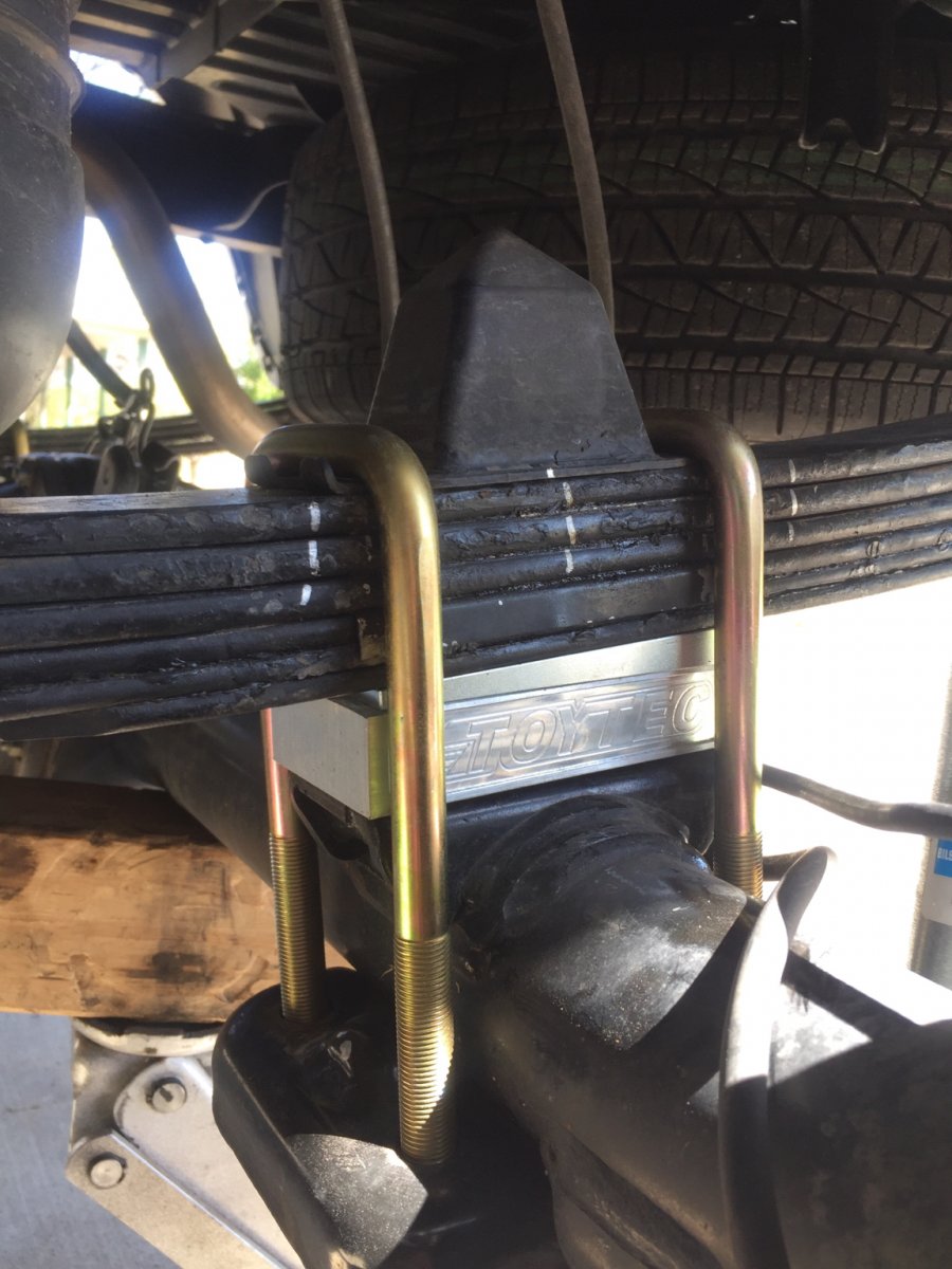

I torqued the u-bolts to 95 ft-lbs and still have the vibe at 25mph.
Ended up getting the 3 degree shim kit (does not come with u-bolts).
If you go with just the AAL and have no vibe, you will be good with the u-bolts that come with the kit the AAL kit, these are grade 5, 8” u-bolts.
If you do a 1” block, you will get grade 8 u-bolts with the block that are 9.5”.
I was able to use the grade 5, 8” u-bolts for the AAL & 1” block.
If you shim it, you will need to use the longer grade 8, 9.5” u-bolts.

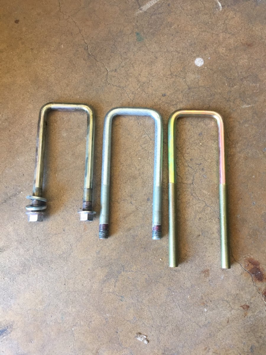

Here is a pic for reference & installed.
Left to right:
Stock 7”
1” lift block 8”
1” block w/ 3 degree shim 9.5”
