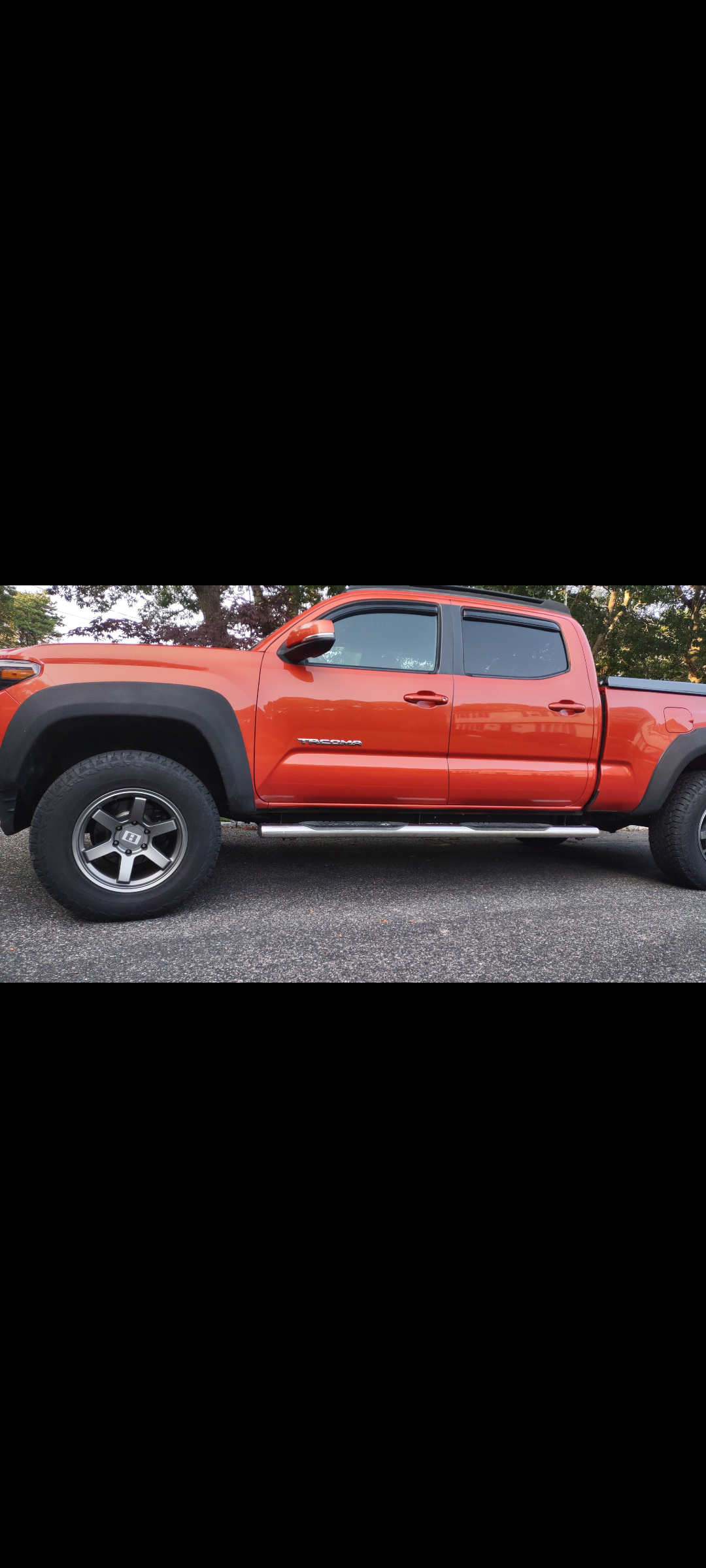

I spent 1200 on my tires and wheels from extreme off-road and custom Screenshot_20230820-181746.pnglevel 8 is company I did 17 x 9 but would do 8s next time with 0 offset 4.5 backspace.and I put on 265-70-17 .I like the 16inch choices for tires better also.
