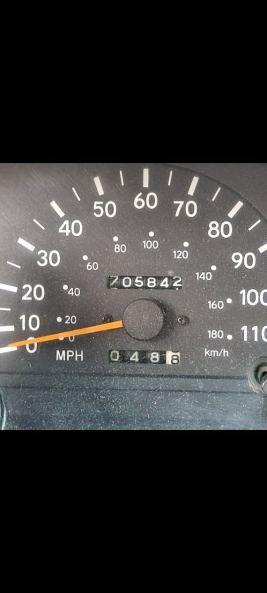

taco John in Denver! i thought you recently cleaned up your cluster lens...
i recently stumbled upon a method to get that dusty off without inducing those pesky scratches
Feb 2o22 to Aug 2o22 compareIT
705842 - 687000 = 18842 / 6 = 3140
266555 - 238500 = 28055 / 6 = 4675
April 2o21 to Feb 2o22 compareIT
687000 - 660000 = 27000 / 10 = 2700
238500 - 194717 = 43783 / 10 = 4378

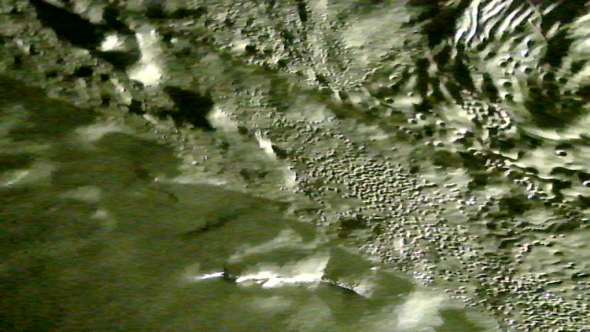

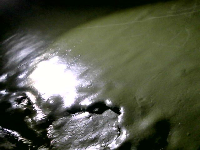

IFC today. by the cat
stage 1.
green
stage 2.
a 2nd coat of IFC green

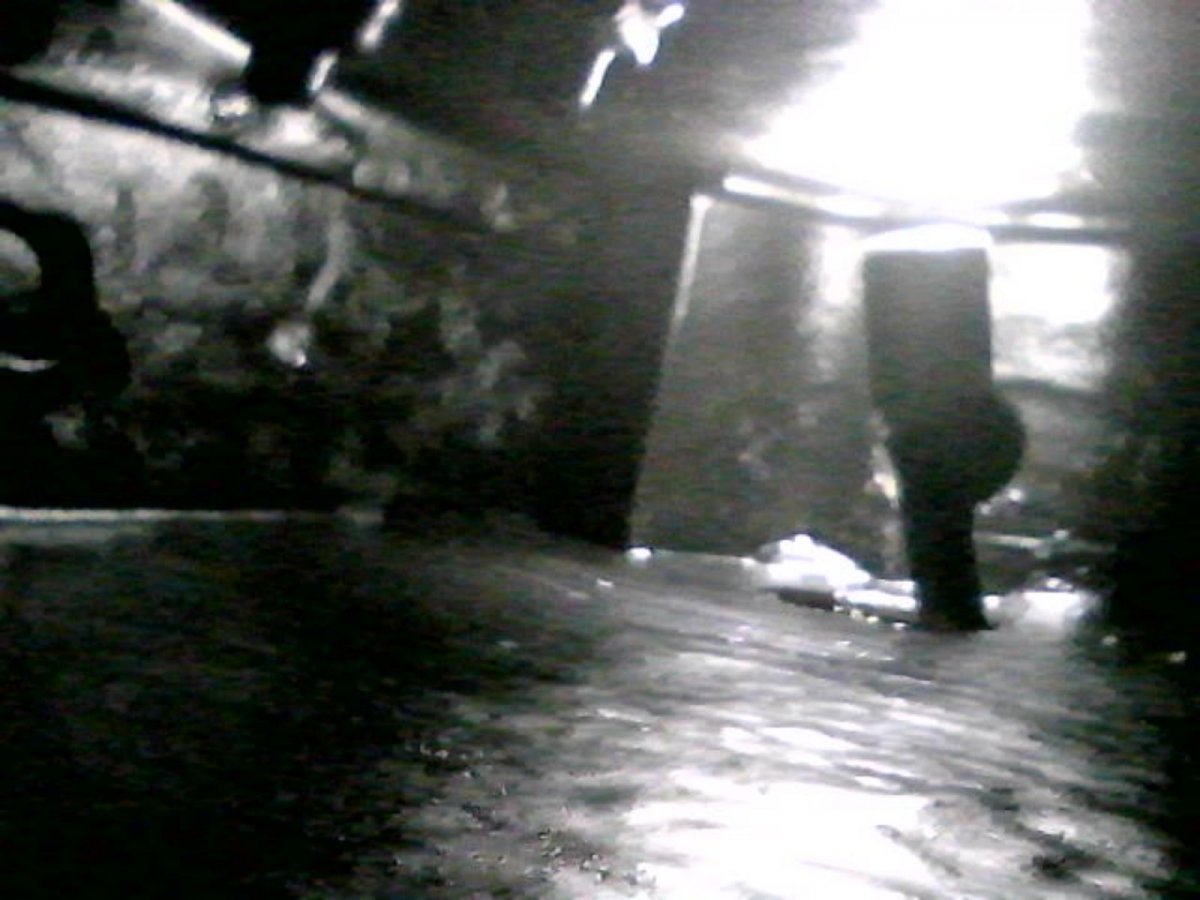

go in with inspection camera to check for any missed or light covered spots in the dark corners

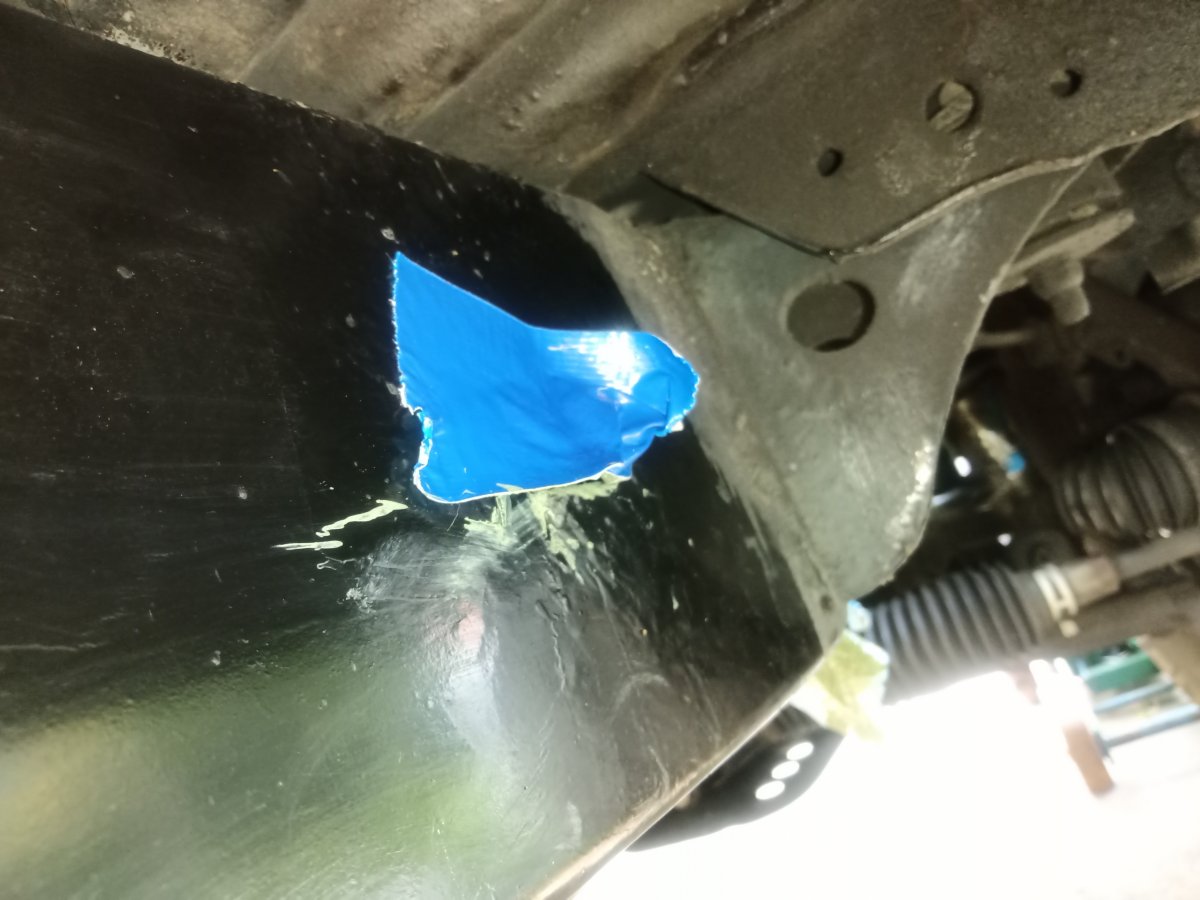

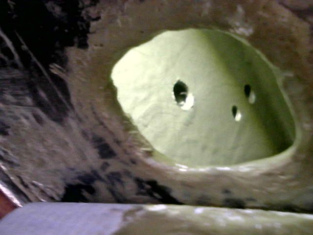

stage 4.
Check on green IFC by cat
I let it dry for 36 hours...

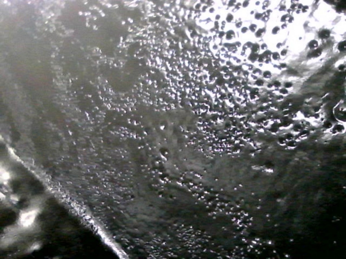

adding first coating of black IFC over the green
applied quite liberally with relative humidity 60% the paint sat mushy waiting for fully proper cure

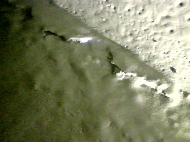

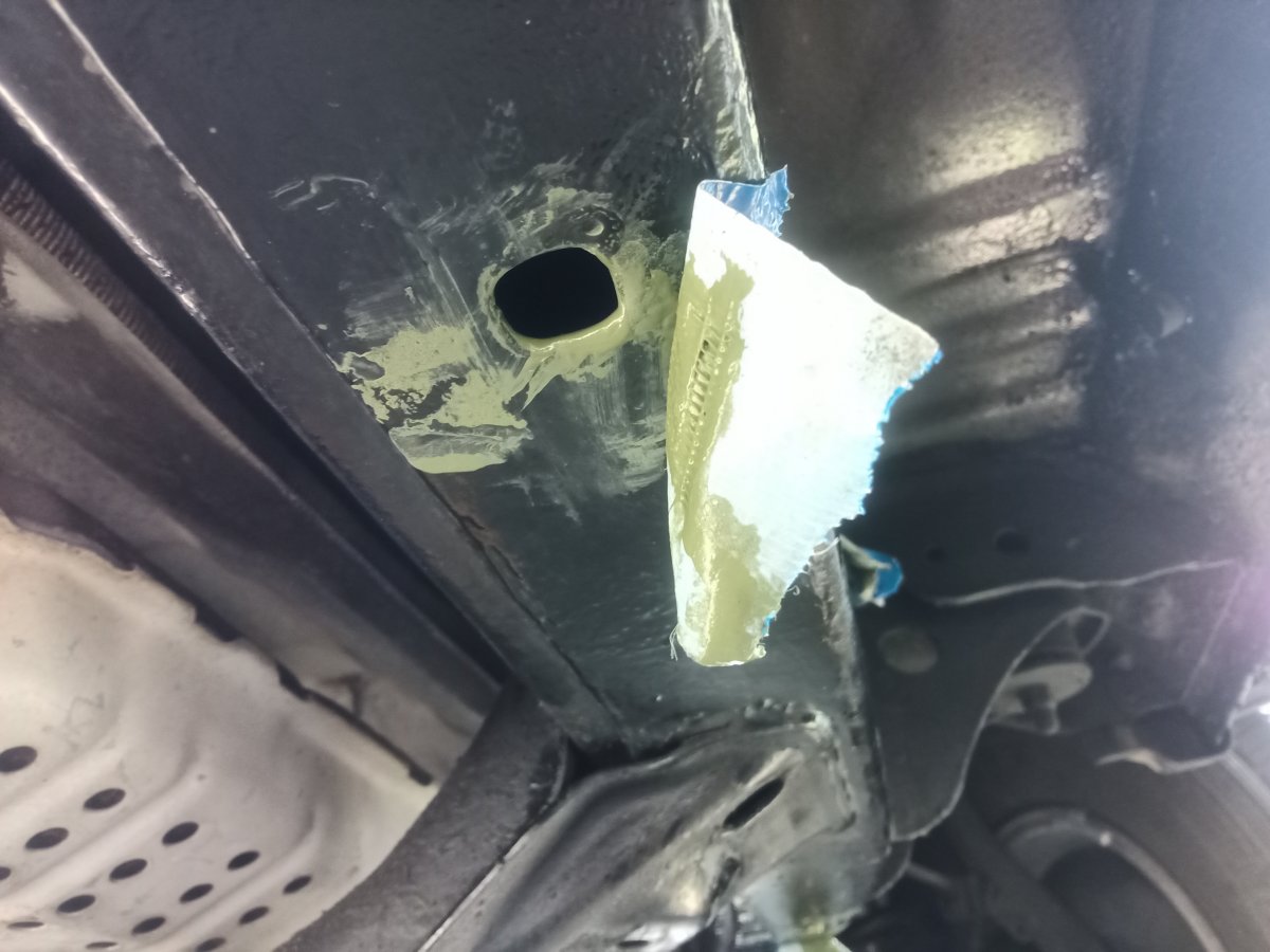

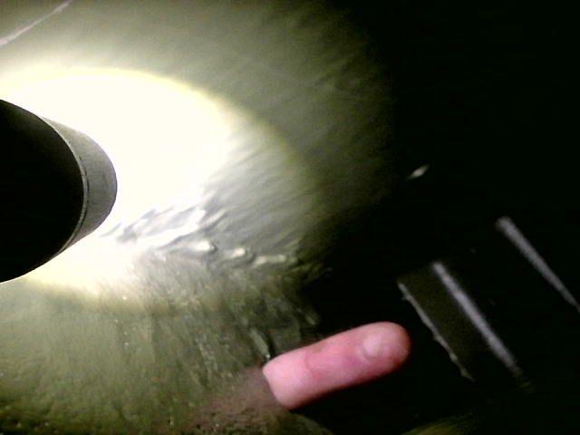

big drain hole by the cat.
seven eight second clip of that moving finger
:confused:

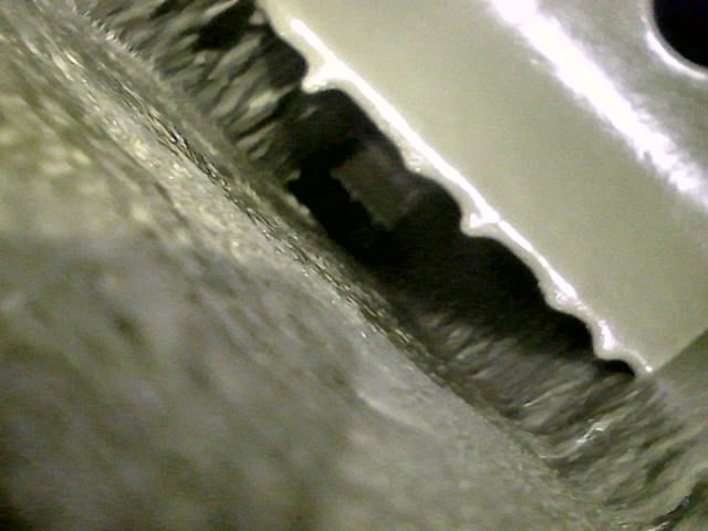

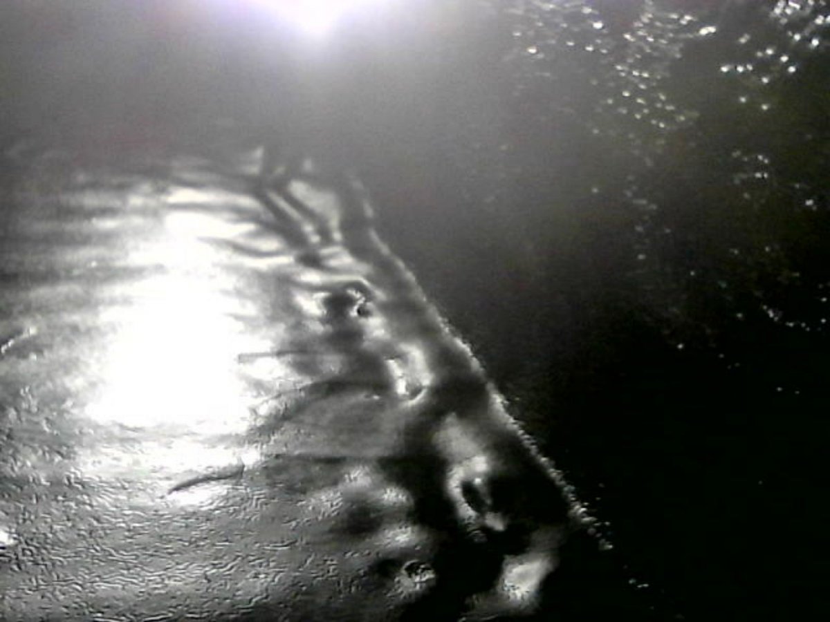

stage 6.
IFC coating by cat

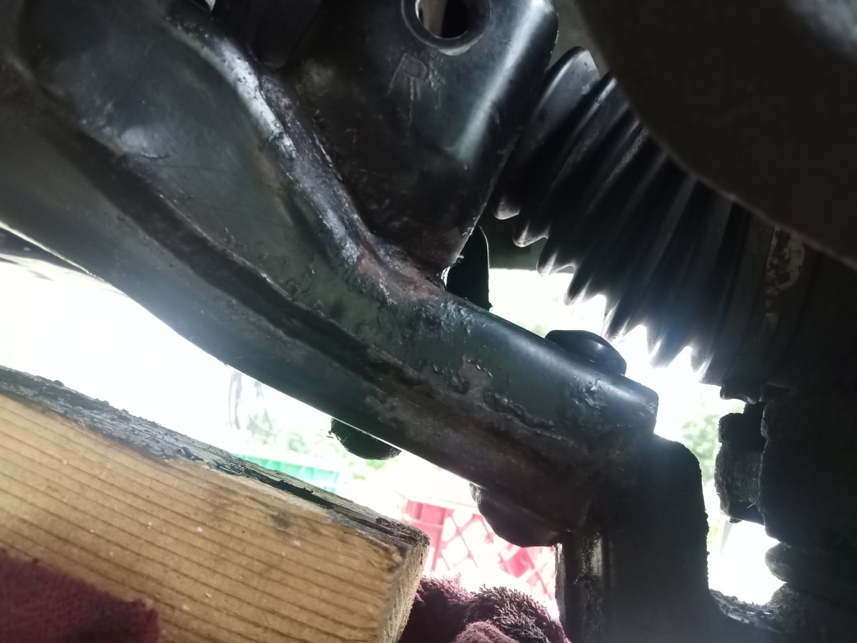

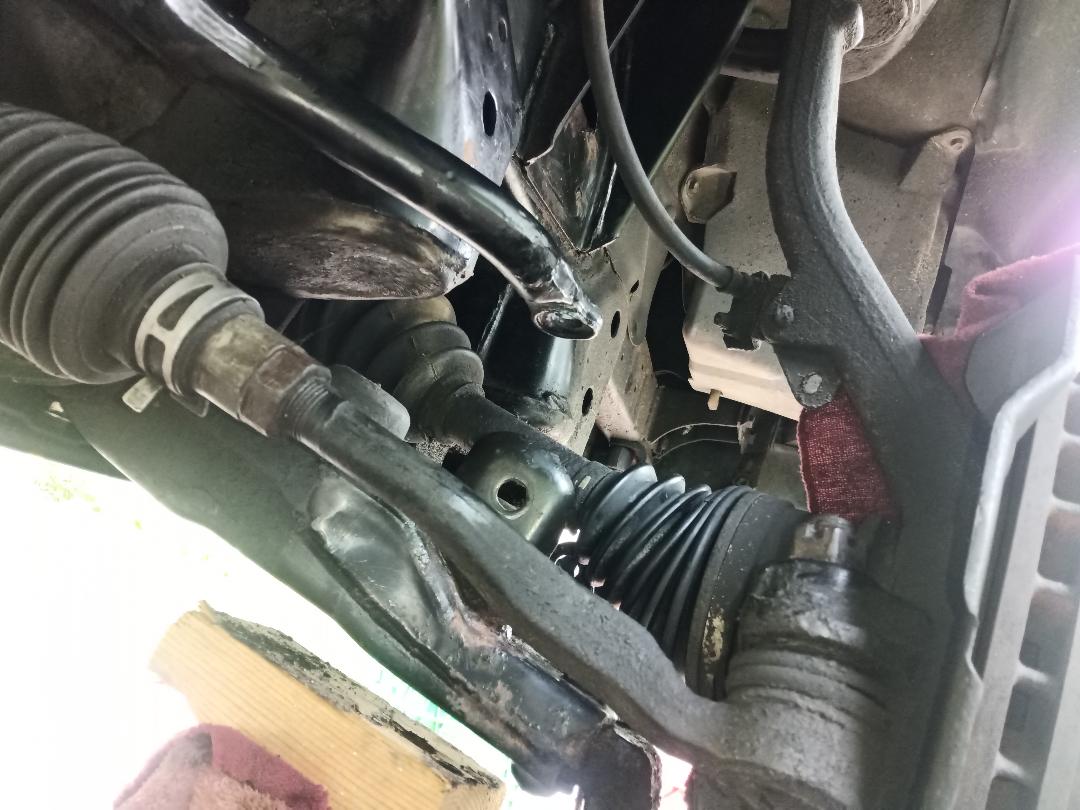

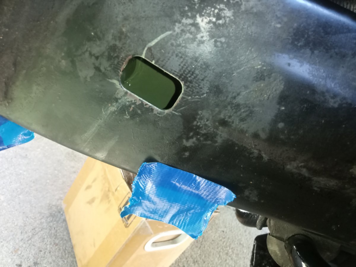

reCheck coverage of black over green whilst workin' at that LCA cleanUp ready for new quikStrut install + stabilzerLinks
20220829111113.jpg 20220829110940.jpg 20220829110839.jpg IMG_20220829_105442_324.jpg

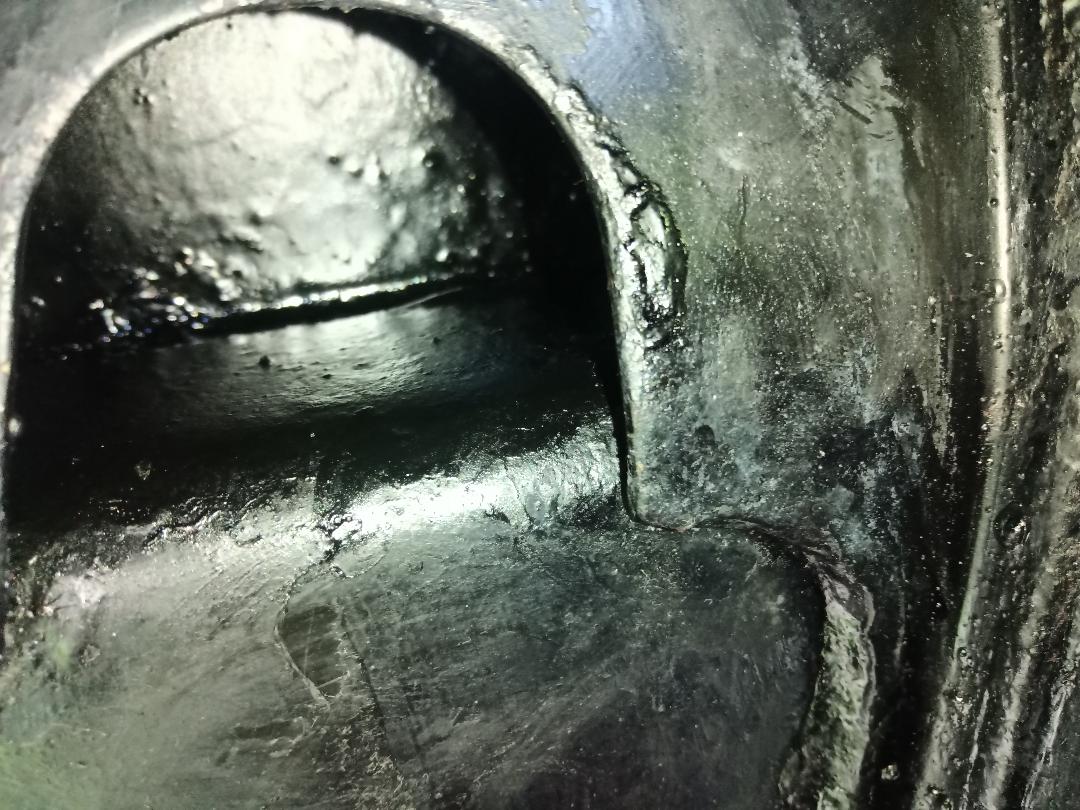

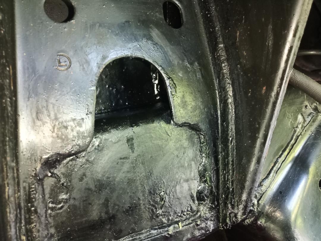

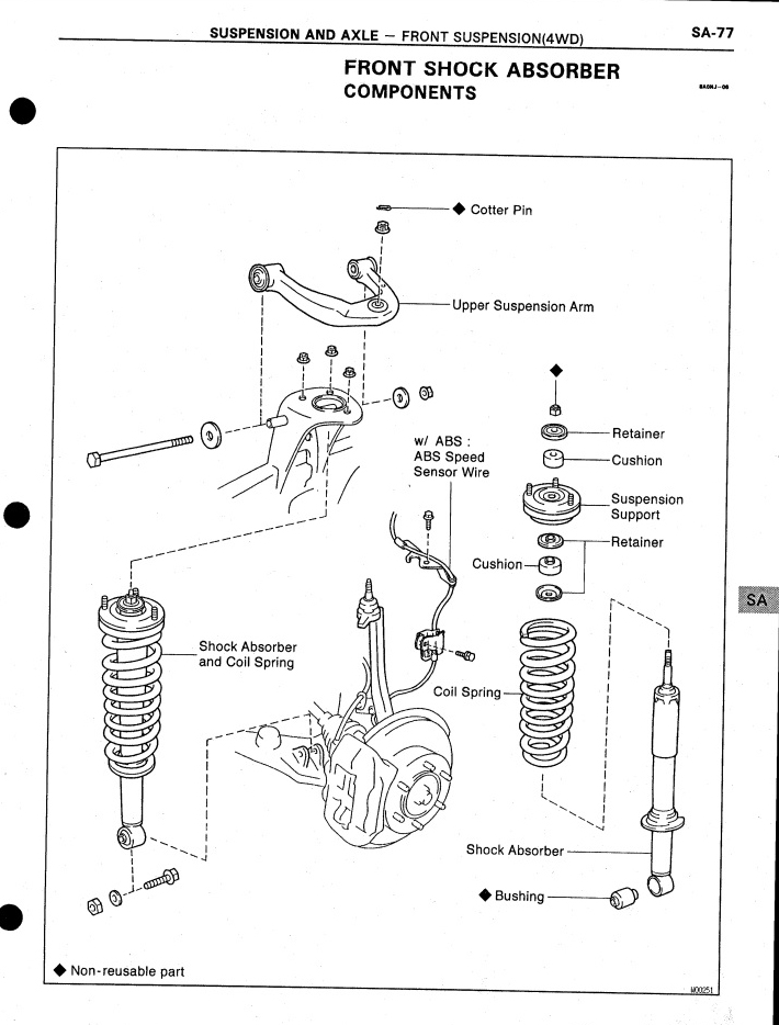

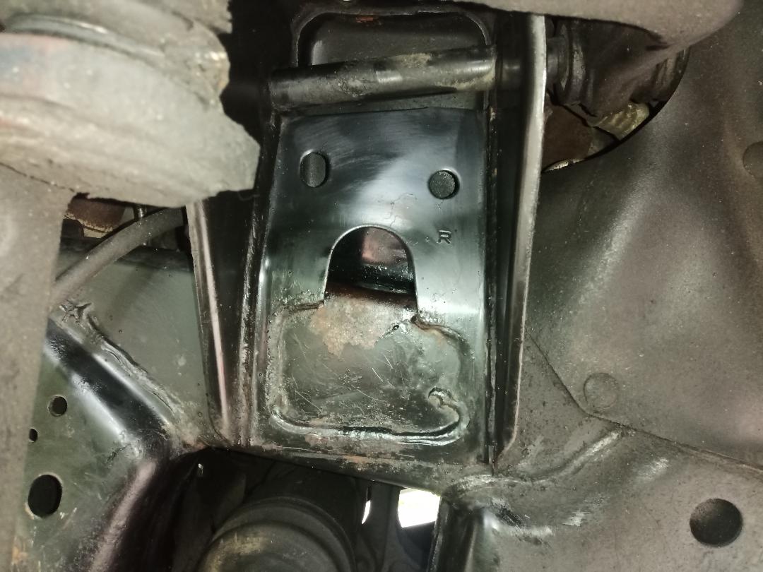

in the midst of replacing front shocks and 25yr old stabilizer links i found this cavity behind coils i was unaware and never seen B4
cleaned, treated and painted interior with black IFC

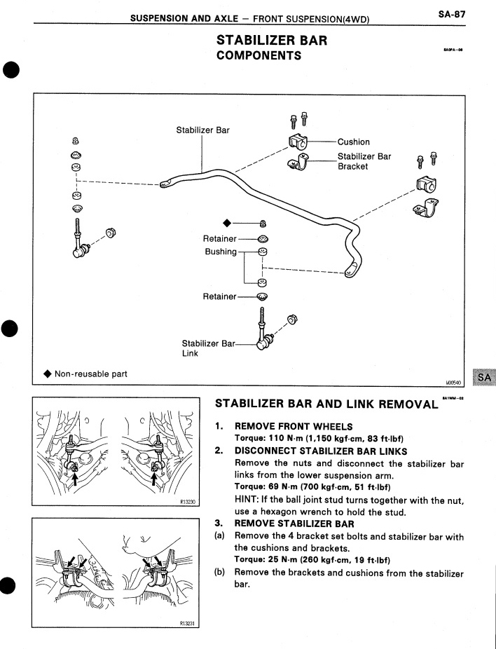

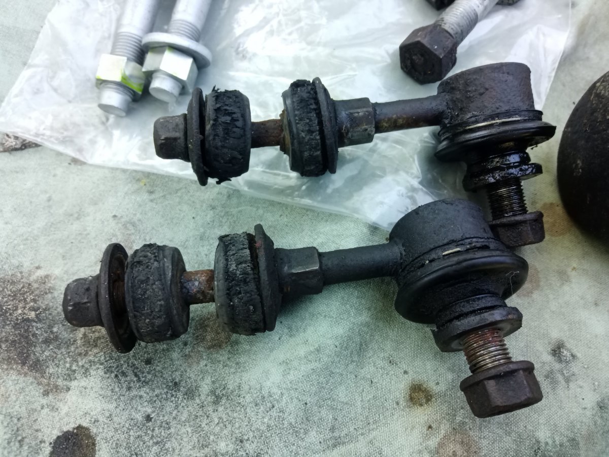

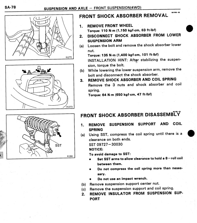

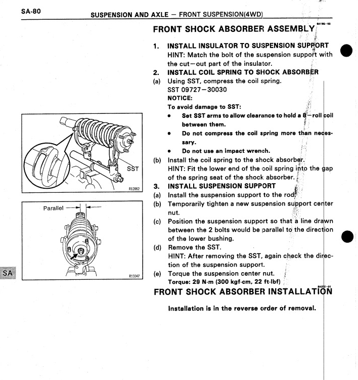

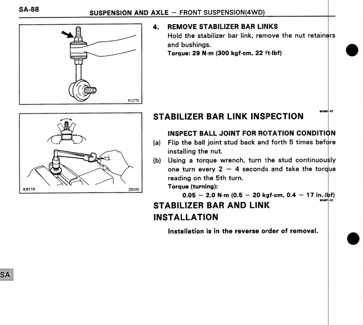

replacing the 25yr old stabilizer links with MOOG brand that need to be greased after install
do i suppose the torque rating is same as the OEMs ?
