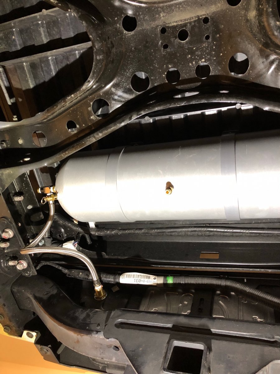

Vixen air 3 gallon aluminum tank

All Stainless steel braided lines with JIC fittings.

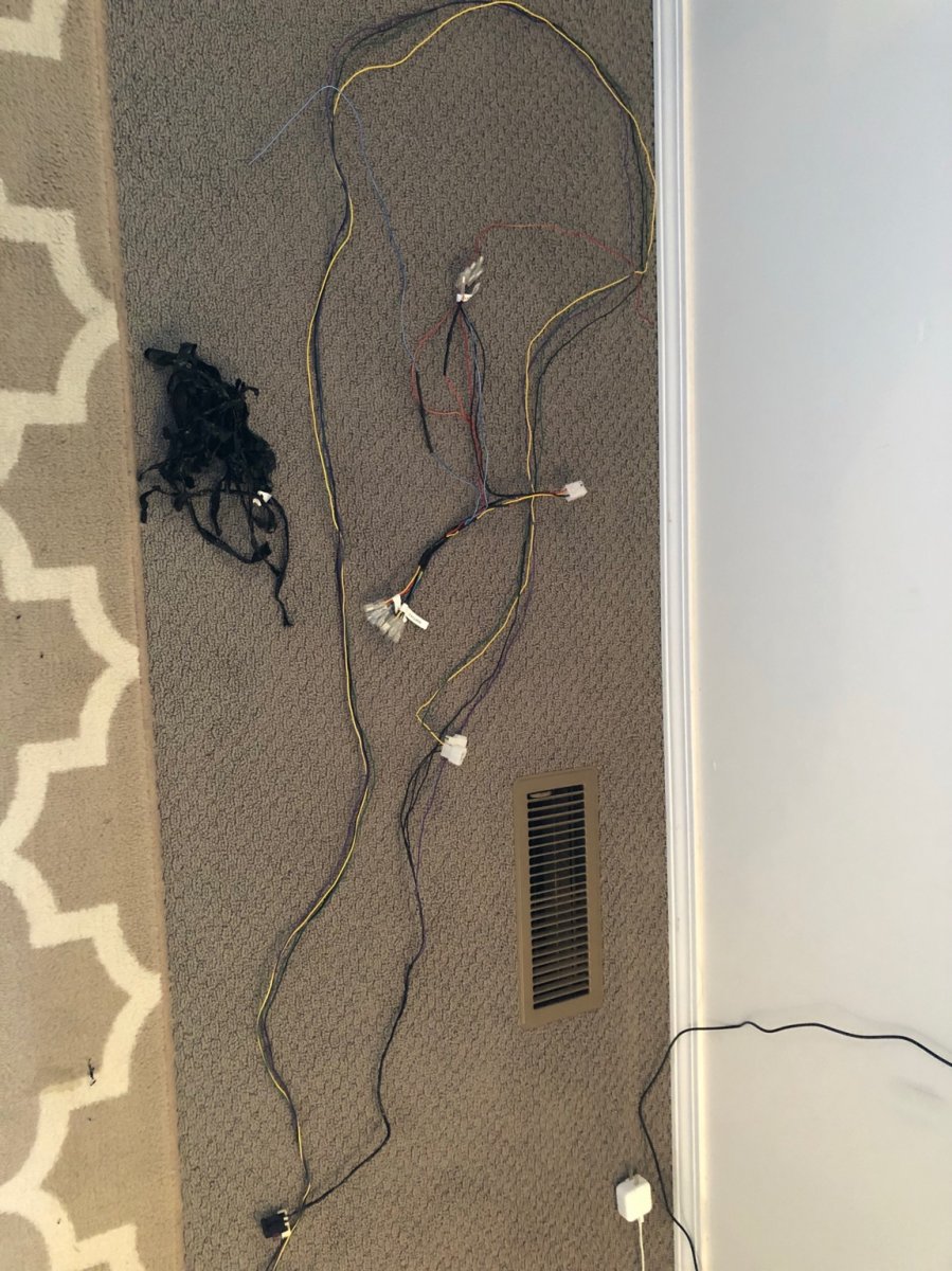

ARB Wiring harness after removing all of the electrical tape
Parts of the harness that were not useful

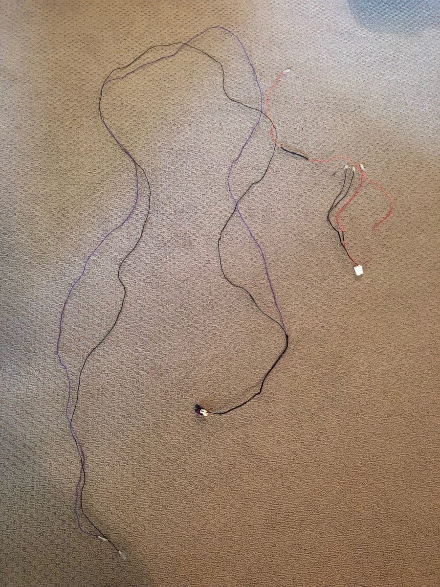

Harness after it was cleaned up, prior to heat shrinking.

3 gallon air tank mounted and fully plumbed. I used a T on the exit so that I can run a hard line later up front for a QD under the front bumper in the future.
