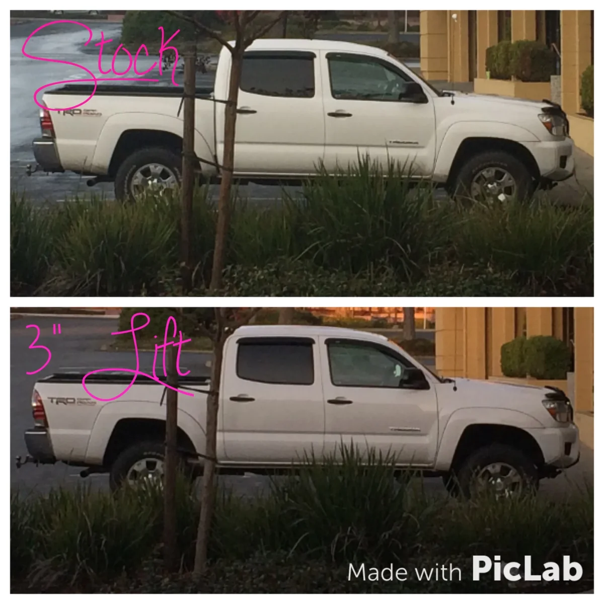

2" front and rear.
front: Eibach 620s, with bilstein 5100s set at 0 lift
rear: tsb 4 leaf pack, icon progressive add a leaf (aal), overload removed, bilstein 5100s.
Superbump bumpstops all 4 corners, rides plush.
LT 265/75/16
rear
front
I forgot.............no swaybar, rides much smoother but ur gunna have to get used to it IF you do choose to delete it. Leans more, but its sooo much smoother, better droop offroad into uneven surfaces and is a TRUE IFS

The offroad has progressive coils and will ride kinda rough when u preload using 5100s. Id suggest 5100s set at zero lift, and either eibach or ome coils to do the lifting, and a 1/4" top spacer for the FRONT DRIVER SIDE ONLY.
That said, the rear will settle a little in a few months. The leafpack is weak after all.
The small spacer for the driver side is avail from toytec lifts, as is the eibach coils. The spacer IS NEEDED if u take the stock coils out because your truck is heavier on the driver side. The stock coils are side specific because of this.
Post #3 is my truck with eibachs, 5100s, and a progressive rear add a leaf. I have an offroad as well, and would never preload my stock coils.
