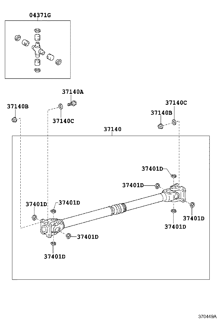

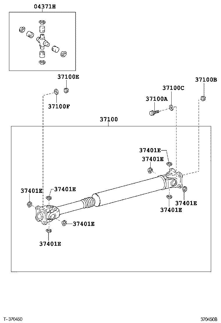

how many grease fitting are on these shafts?
front prop shaft
rear prop shaft

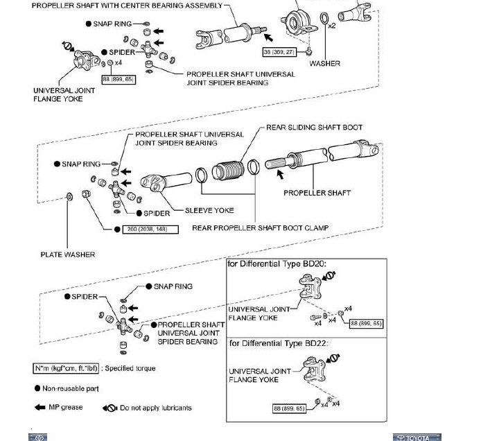

truck does not have center bearing assembly

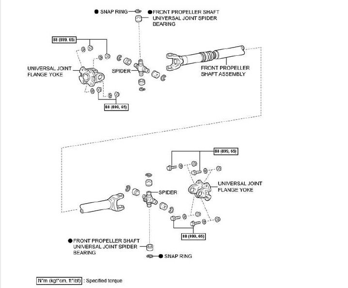

torque specs?
65 foot pound = 88.14 newton meters.

FWIW, 65 ft-lb seems high for these bolts. They do not have a large body diameter. Remember, torque values refer to the body diameter of the bolt, NOT the hex size.
