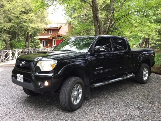

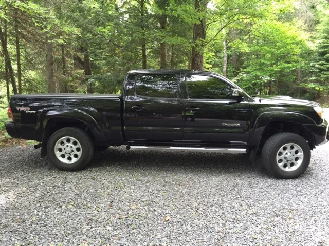

Here are the pics finally uploaded from my phone. The first pic almost makes it look lower in the front. The photo was taken after doing a 3" front lift. The kit came with 2" blocks for the rear but I don't think it needs it. The truck is perfectly level without a load. Thanks Demo Man.

If you load it now rear will be lower than the front and a bit of oversteer will be felt! I always like the rear up a few inches for this reason!

It wont i have same lift
I got the 2" spacers installed yesterday and the back end is definitely higher but no more of an angle than stock. I don't know why they call it a leveling kit because it's only level if you don't do the back end lift. I'm happy though and will leave the blocks in.
Name is deceptive but imho it needs that little bit of rake
