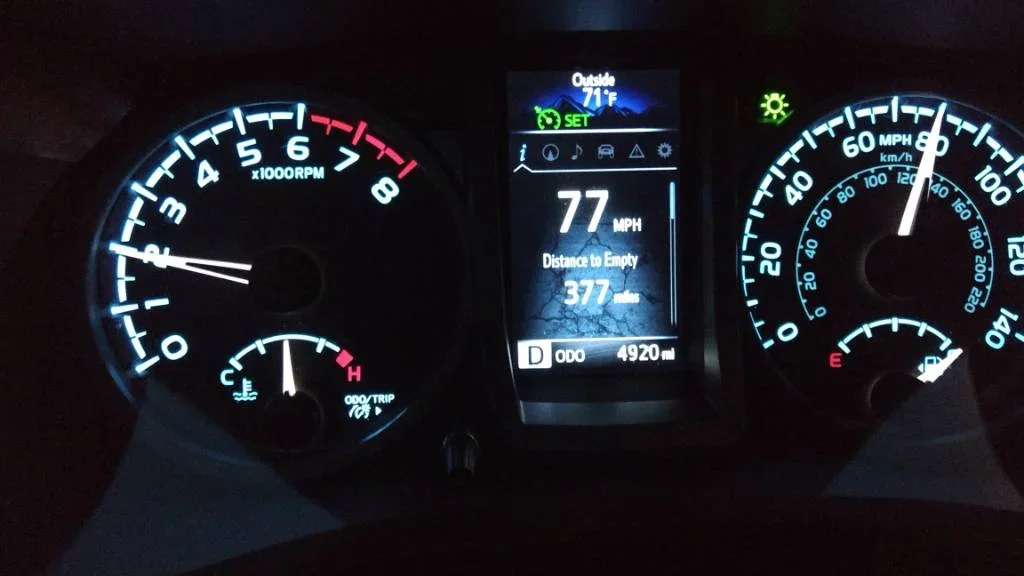

Well I know I can use 83 octane in my Taco but when questioned about what kind of gas can be used in a Toyota Tacoma I looked it up on my manual and it said nothing less then 81 octane but further reading I read somewhere that for better performance try a higher octane which I did (93 octane ) and I have notice it's as if my Taco woke up. Not only am I getting a better performance but it looks like better gas mileage as wellIMG_20170802_054520202.webpIMG_20170728_113246946.webpIMG_20170728_051551804.webp
