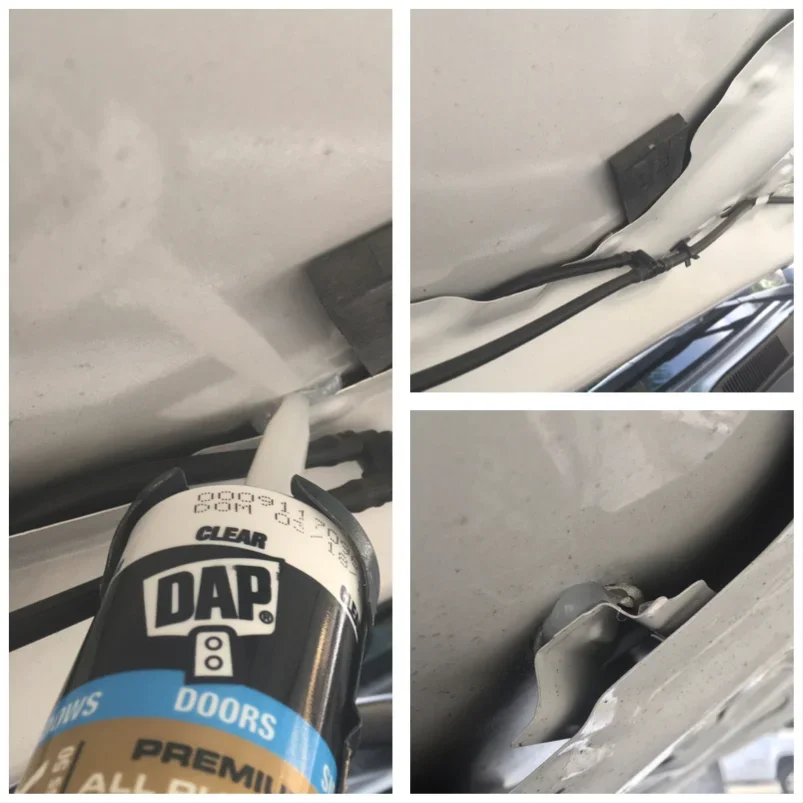

That's exactly what we're talking about. Open the hood and look where the sheet metal meets the hood assembly. You'll see several spots where adhesive was applied. The adhesive is painted, but it is obvious that it's adhesive. Press up on the hood sheet metal at those adhesive points and you should be able to see separation, or elasticity in the adhesive. That will indicate that you need to have your hood rebonded.
$6 fix and no dealer hassle, no paint mismatch to worry about, no fit/alignment issues. Keep your factory fit and painted hood. The dealer paint shop rarely matches the factory paint job. I've seen this thread for over a year and never checked my '16 TRDOR hood after 29K mi. Sure enough, all the adhesive spots were popped lose. The hood skin can't "fly off" as some fear as it's wrapped and welded at the edges. Run by your fav hardware store and grab a tube of HD Silicone adhesive. It's good for over 1K° and below 0°. I used a plastic shim to open the gap at each factory adhesive location plus a few more. Remove the shim and wipe away the excess that squirts out. Let dry for a day and you're good to go. I do remember seeing the center of the hood wobbling at fwy speeds, but no more.
