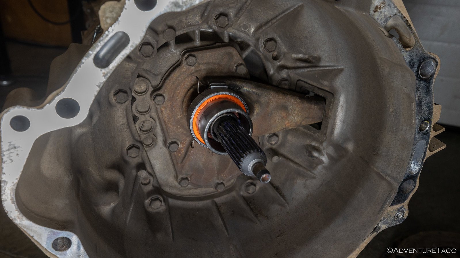

How do you tell if the clutch fork is mucked?
it (bearing) does not squeal or chirp all of the time or even most of the time
just occasionally
Squealing is usually a throwout bearing going tapioca.
As far as seeing the clutch fork, and bearing....even blown up, you can hardly make it out, let alone any defects.

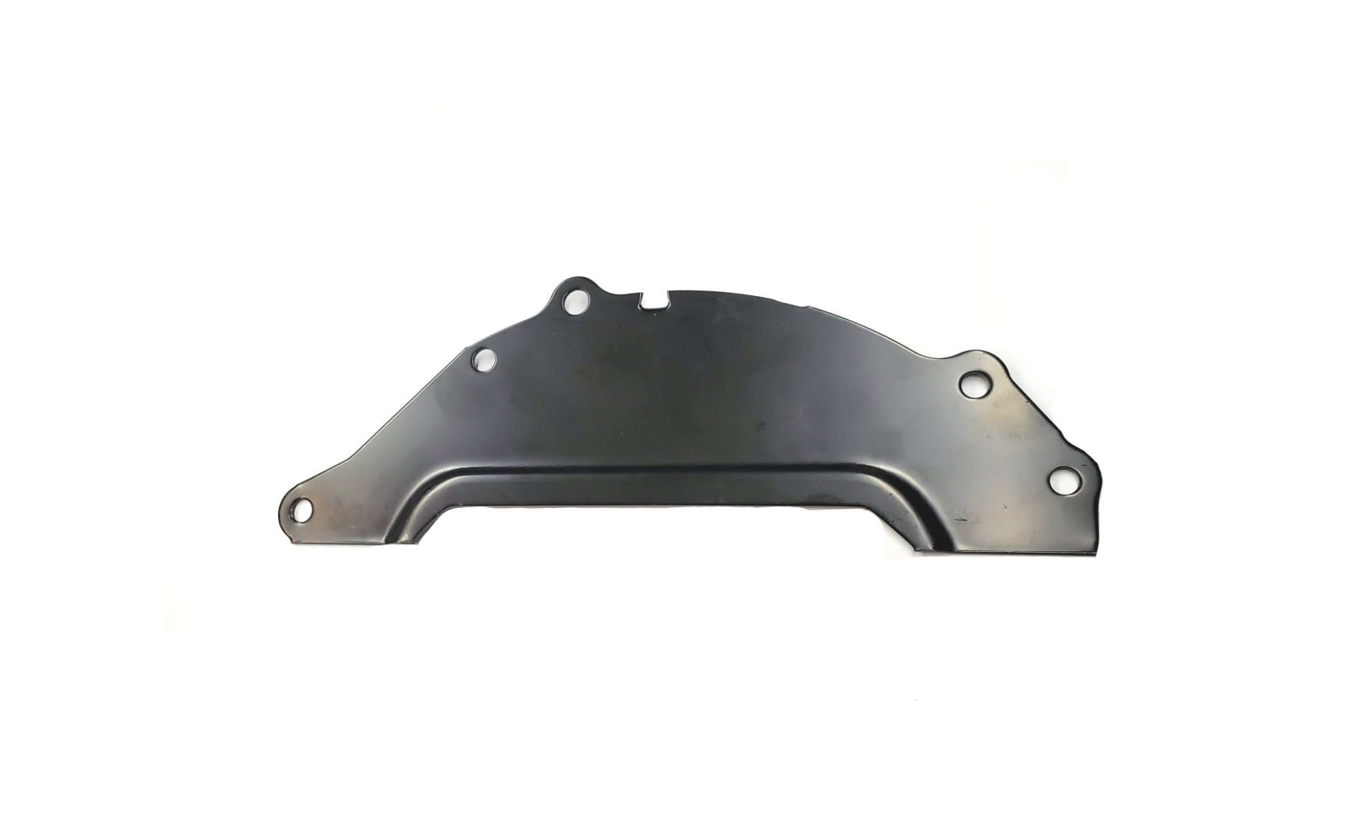

Unless the truck has a bell housing inspection cover to see what the fork, and throwout bearing look like...its gotta come apart.
There is a removable plate in the front there
Looks like a semicircle from Timmy toolman uTubes

Yeah probably depending where that shield is located. Some manual vehicles have a similar shield thats bolted to the lower side of the bell housing that allows you to see the clutch components.
i did spot an inspection hole (fairly good size) by that plate whilst hobbled underneath that could get a peek into up inside, not sure exactly which part i was looking at!

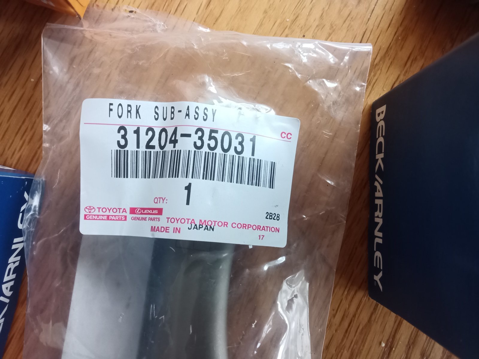

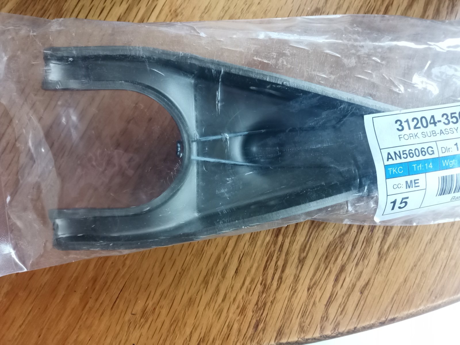

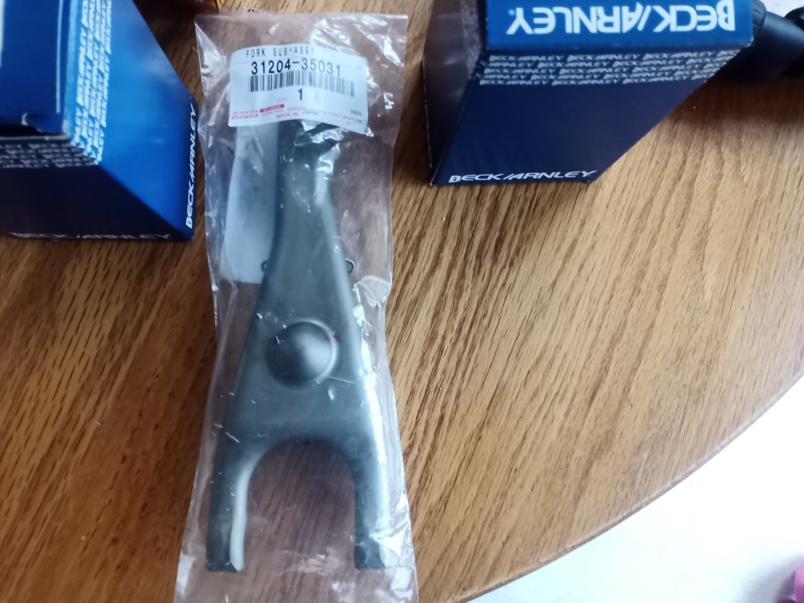

Update: solved!
finally ended up taking it to the shop. They were just as stumped as me, master and slave were fine, line was bled fine. But still sometimes pedal, sometimes not. They continued to bleed it thinking maybe there’s a stubborn air pocket somewhere in the line. While bleeding it the clutch fork broke. Said it was either bent or cracked (probably bent) and it wasn’t getting enough travel to engage the clutch, which makes sense because it looked fine from the outside but I couldn’t see inside the bell housing where the problem was. Mechanic said he’s never seen one break. I just feel vindicated at least that it’s not something I could’ve diagnosed on my own because I’m not qualified to drop my transmission or take it apart. Sucks that the labor will be expensive because the transmission has to come out to replace the fork but all in all just happy I didn’t mess something up. Thanks everyone for your help and suggestions.
i am curious if the clutch fork on the '97 is mucky lookn like this one here...
